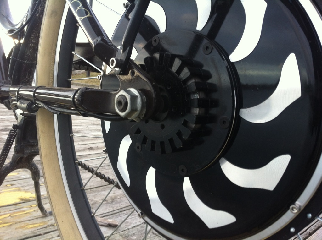

Gary,
Does that latest pie (on the picture) sit on a 26inch rim? It is just that that pie looks bigger and the spokes look almost radial.
Do you know if Pie 2 or Pie 3 comes in 24inch rim? or has anyone tried to install it on a 24inch rim?
Cheers!
I pretty sure that Gary's wheels are 26".

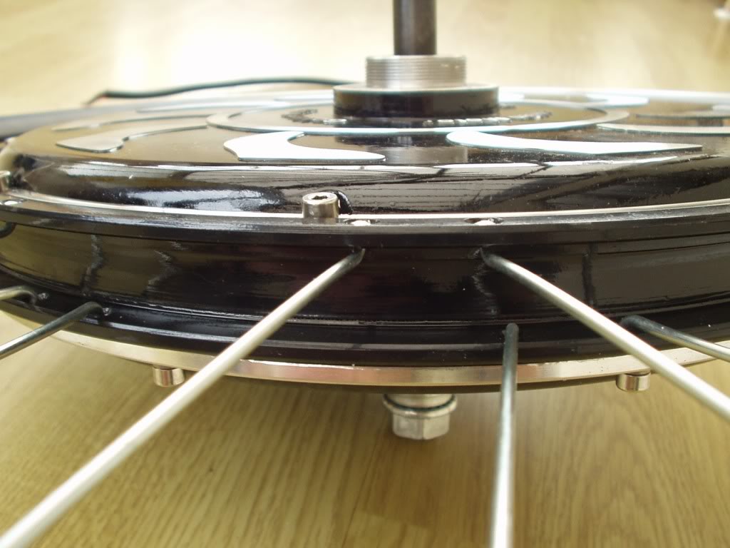

The spoke pattern on the MPIII is exactly the same as the MPII:
                            MPII                                                MPIII
Although the distance between the two spoke flanges is slightly narrower on the MPIII:
Although a 24" rim is not advertised, this picture from the GM website looks to me as though it has a 24" rim fitted on the front wheel:
Assuming you can find some spokes of the correct length, and a suitable 36 hole rim, it should be relatively simple to build your own 24" wheel.

Gary,
Cheers!
Hi
As Alan stated my Townie has 26 inch wheels. The picture is at an odd angle and does make it look oversized.
Of course it does come in 24 inch. But 24 inch is a very uncommon size for people to order. I regularily stock all motor types (901,902,MP2) in all sizes except 18 inch. I have only ever sold one 18 inch so the demand is very low. The 16 and 24 Inch I only stock afew front and rear of each as it they are the second least wheels ordered. If someone orders one I still have one in stock and order another asap. Then the inventory climbs from there. By far the most comon is the 26 inch rear and thats about 90 percent of my stock.
                            MPII                                                MPIII
