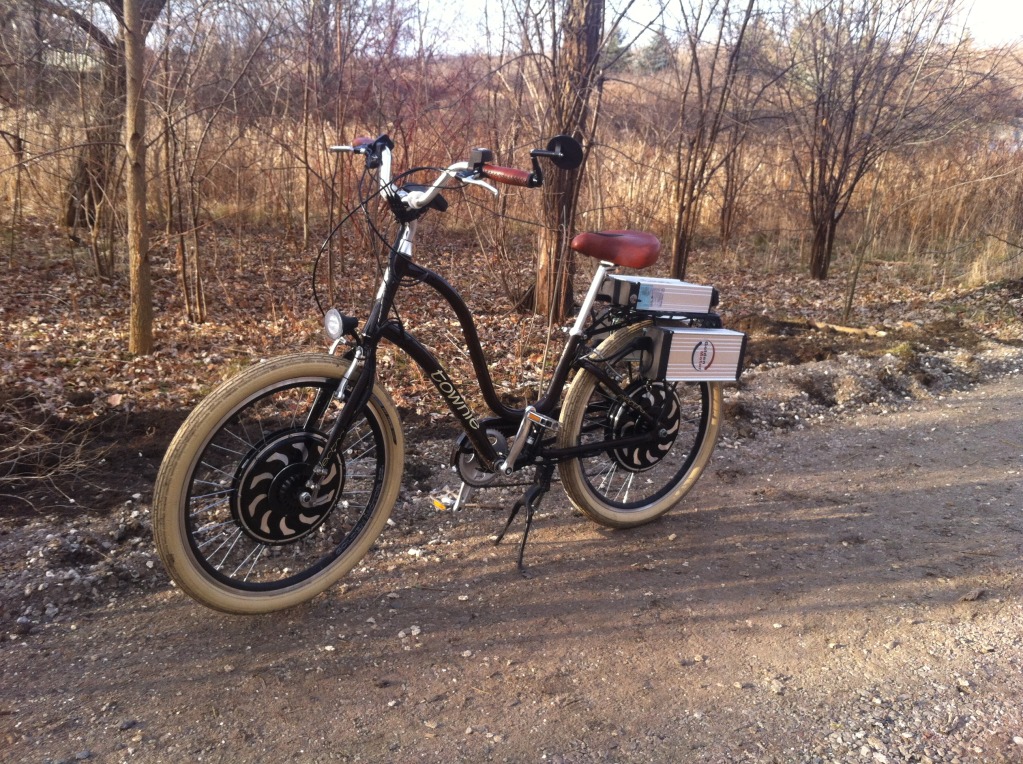

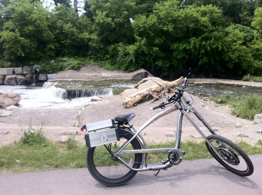

The Magic Pie is not good for Mountain bikes? What about these?
My Wife's mountain Bike. At least that's what I call it :) This bike is excellent in the bush on some rough muddy trails. A lot of fun, great for jumps etc.
Then there is My TRI-PIE. This bike is all about torque and take off. It really is an amazing amount of torque. 1000's of kilometres no issues.
The Magic Pie is also great for my Tandem bike. Anyone that goes for a ride with me on this can't believe the power of just one motor.
I would say Magic Pie motors are suitable for many styles of bikes. To say Magic Pies are not good for Mountain bikes is not correct in my opinion. Actually for an all around bike I think the full suspension Mountain bikes are the best conversion for Magic Pies. Well except for my Townie I guess :)
Now a lightweight aluminum folding bike. Maybe not. But pretty much any other bike is fine. These are my four current rides. I have cut my personal collection of ebikes down to these four. Well and two Shrinkers. But who is counting :)
BTW the first 3 pictures are all MP2 externals and I will be selling the motors off of them soon. Gotta go MP III all the way now!
« Last Edit: February 11, 2012, 02:20:49 PM by spellchecker »

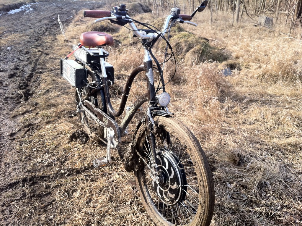

Re: Magic Pie III Updates
« Reply #66 on: February 20, 2012, 04:37:13 AM »

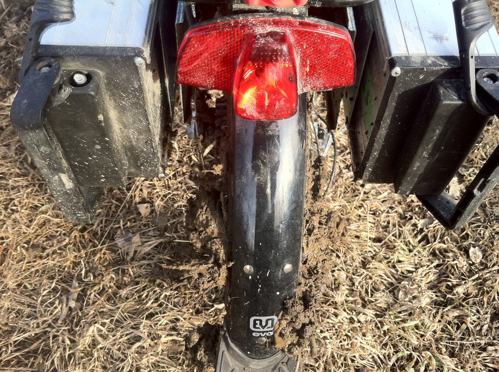

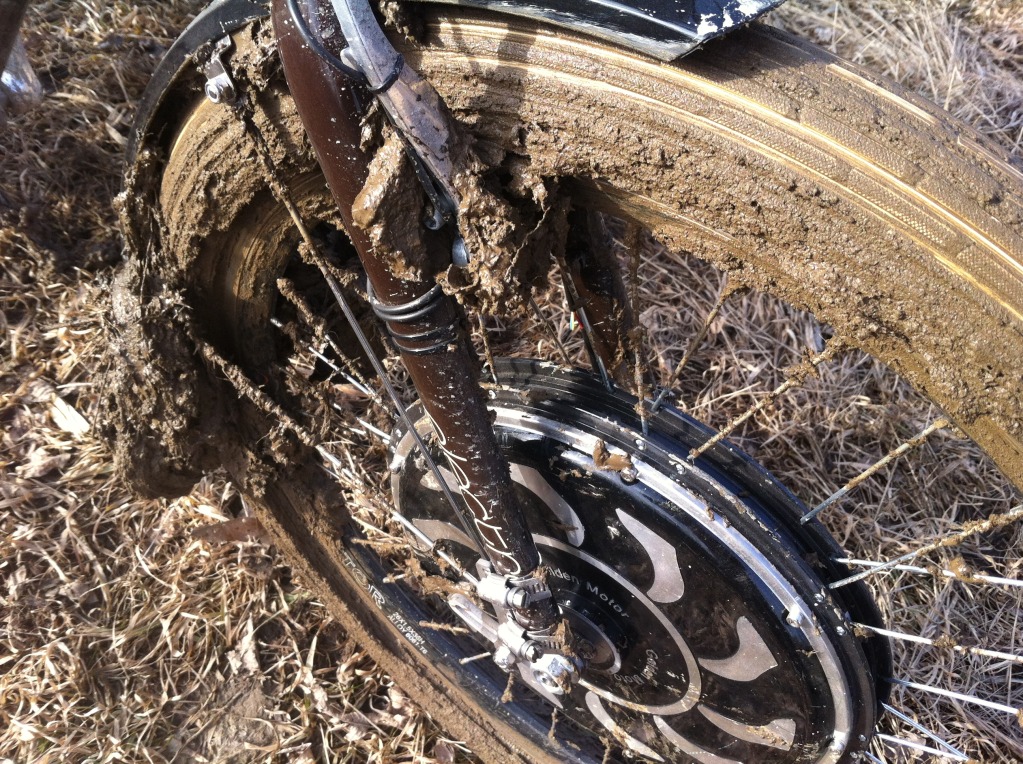

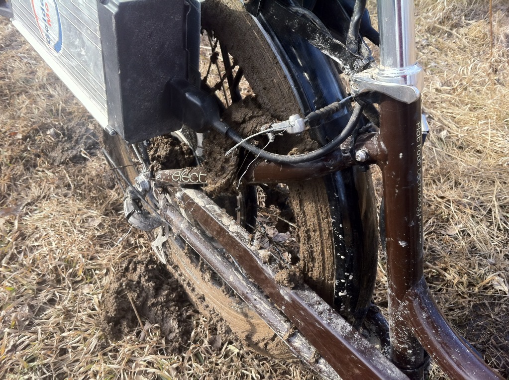

Took the Bike out for a Mid February MUD ride. Normally this area would be all snow and Ice. We are having a very mild winter this year!
Video too..
http://www.youtube.com/watch?v=epfwXtlVLyA&feature=email&email=comment_received
Last time all that MUD was on me!

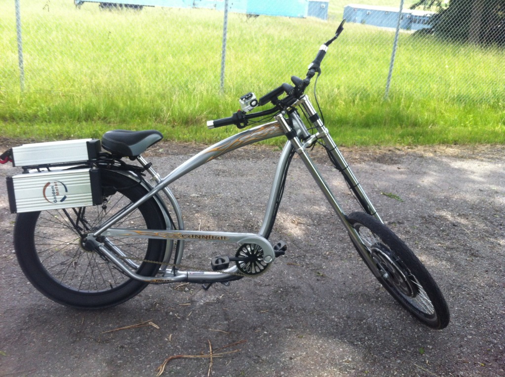

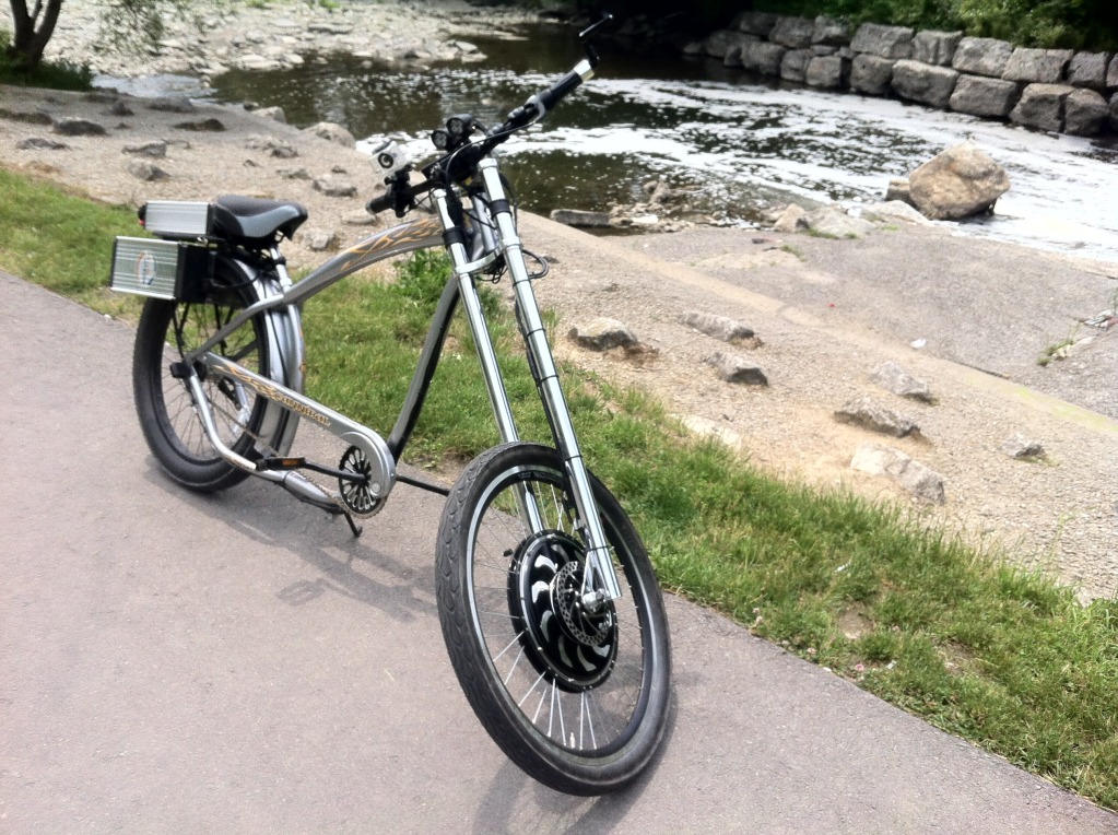

Just thought I would toss in a few pictures of my next conversion. Bought it today, picking it up tomorrow. This one is going to be special!
« Last Edit: May 30, 2012, 03:41:13 AM by GM Canada »

« Reply #72 on: June 07, 2012, 12:19:29 AM »
It looks like someone's been busy recently, haven't they Gary?

Gary , are you using a thumb throttle since the three speed shifter is twist ? Gary you are costing me money . I just ordered the bike and will start stripping down my beach cruiser MP for the conversion . I have a twist throttle so I might move the shifter to the left side of the handle bar . The bike should be here next week . Mine is suppose to come with a disk brake on the front which should work with my MP2 and the offset front wheel that drives me crazy . I'll keep you posted . Rod

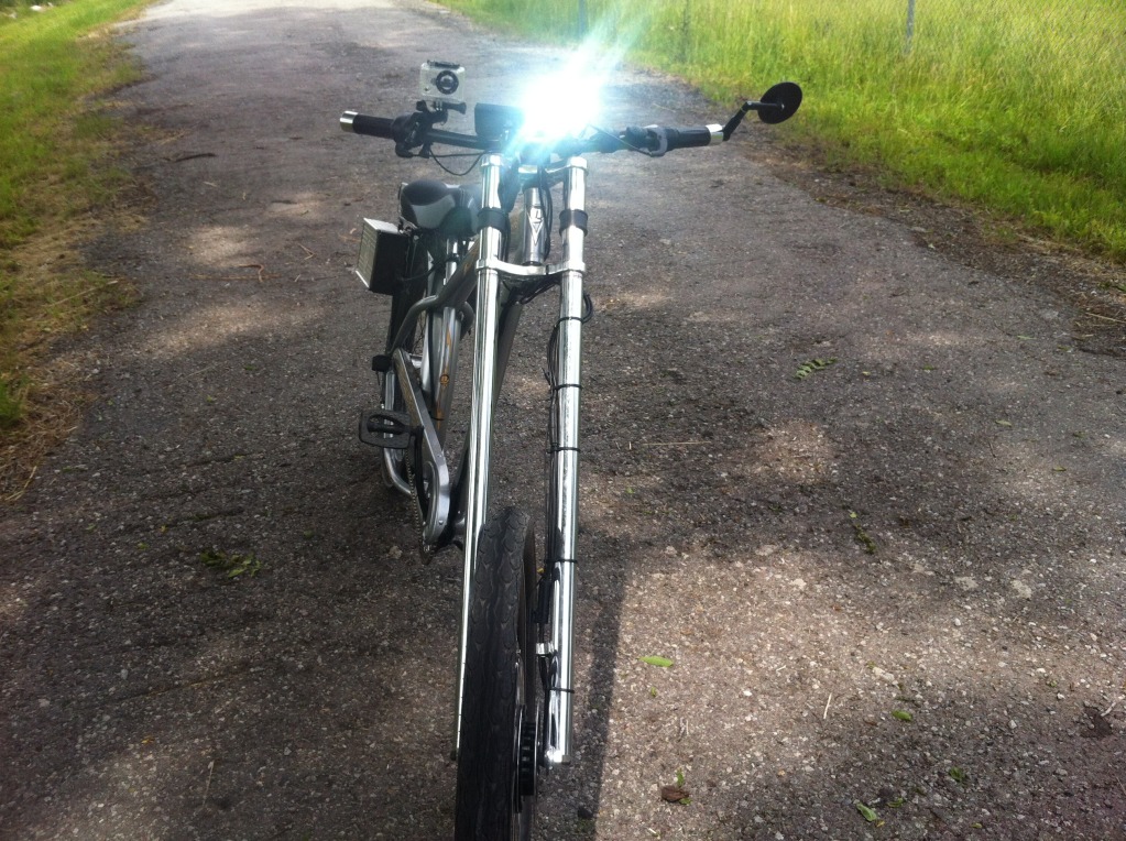

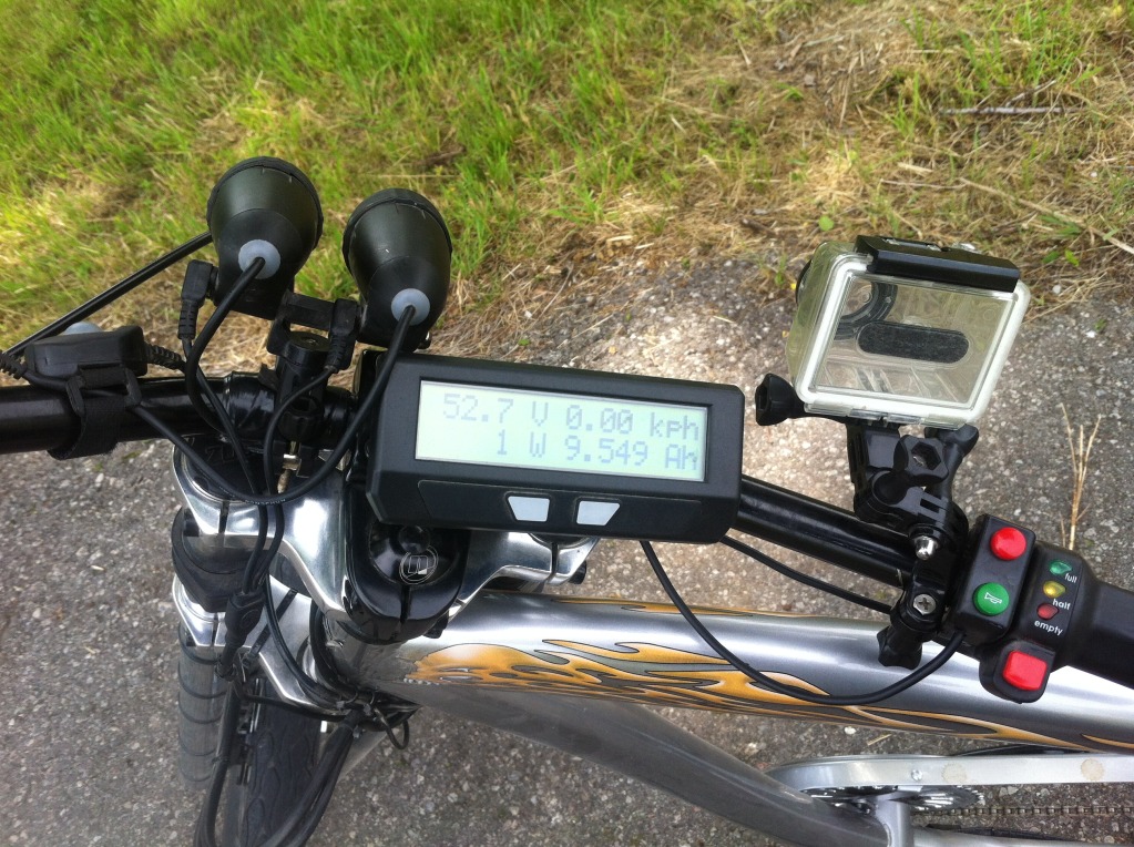

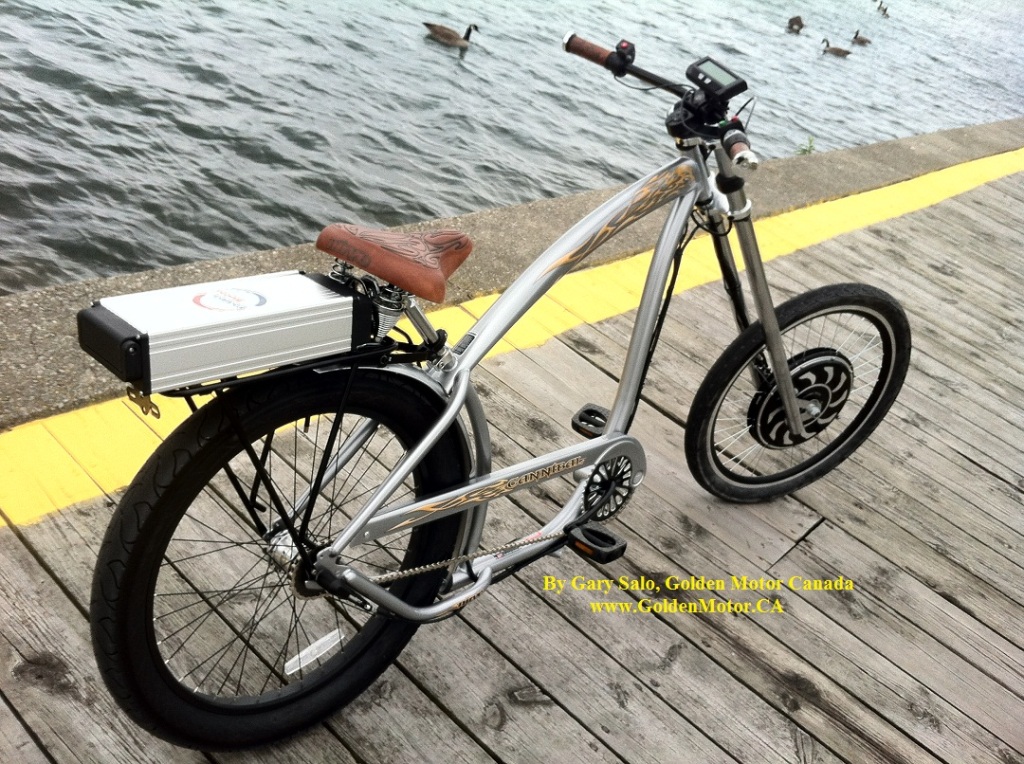

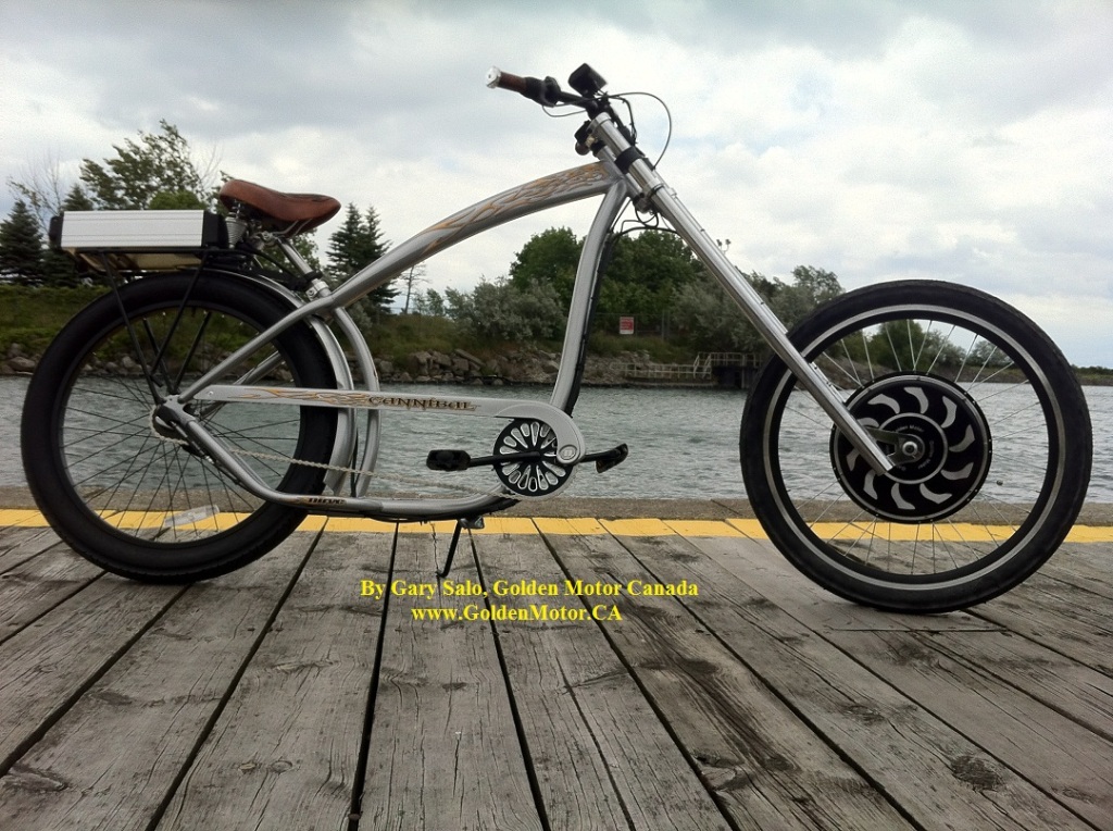

« Reply #74 on: June 12, 2012, 01:51:46 AM »
Ok You caught me! Theres no Hiding from you guys! Here are some more pictures. I'm still working on it when I have time. Too much stuff on the handle bars I need to add another bar. At first I had the thumb throttle, I switched to twist to get more of a motorcycle feel. I moved the shifter to the other side, the numbers are upside down but thats no big deal. I also changed the seat, niot as comfy as it looks and alot of interference with the battery rack. Still tweaking. It will keep improving.
