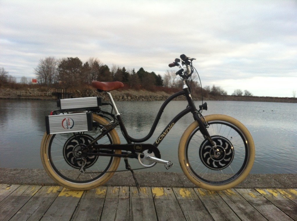

Before
Townie 8 Speed with internal cabling. The cables run inside the frame for part of thier run.
After Conversion.

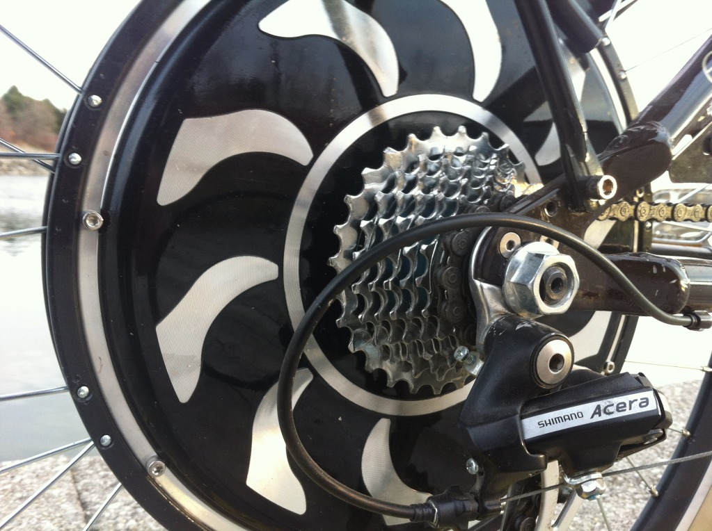

Added two Internal Magic Pie 3 Motors, a rack with three batteries, lights and a Cycle Analyst. I Built this bike once with my first two pre-release MP3 Motors. It was a quick build with little effort to keep the "clean look".
Then I completly stripped it when I received my second set of MP3 pre-release motors. Since the wiring harness has changed nothing is compatible with the frist two motors so everything had to be replaced, motors, levers, buttons, trottle, etc.

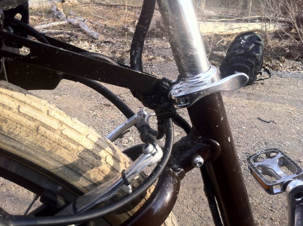

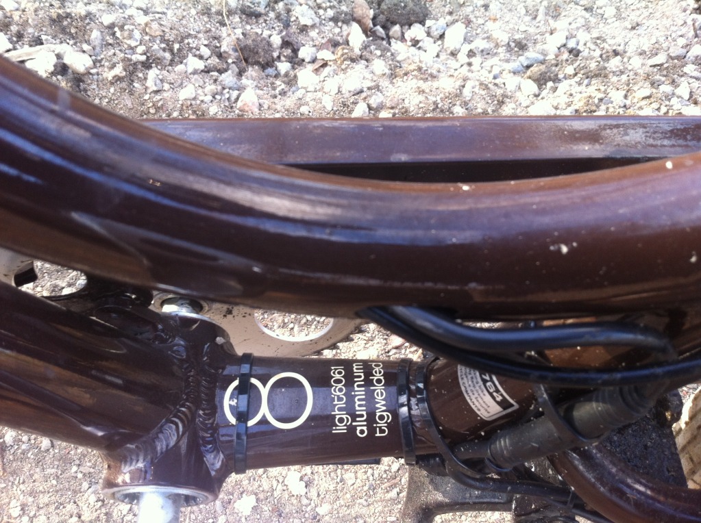

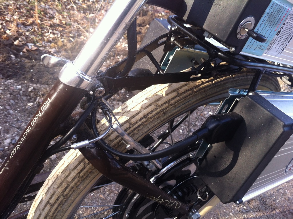

This time I took alot of care to give it as clean of a look as possible. I routed all the wires through the frame along side or the original cableling.
I think it turned out pretty good and I absolutly love it!
After looking at that last picture of my bike I can see I should level the battery rack as it was before. I think it looks better that way.
