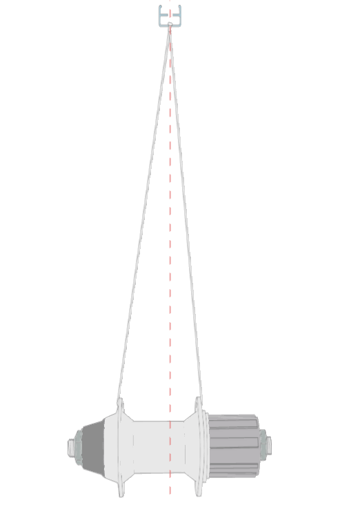

Your MP5 should not have the offset rim problem, so there are three possible causes:
  • Your wheel has not been fitted in the correct upright position and is tilted slightly to one side. The wheel will need to be refitted into the fork dropouts making sure it is in a perfectly upright position.
  • The hub has more spacer washers (or Torque arms etc.) on one side than the other.
  • The spokes were not originally fitted with the rim perfectly centred and will need to be adjusted to bring the rim into the correct central position.
Hi Don,
It's the hub that needs to be slightly offset to the right to allow additional room for the brake disc on the left - not the rim.
If you have a cast 16" or 18" front wheel and suspension forks, there is not much that can be done to reduce the offset. I may be possible the tweak non-suspension steel forks slightly to reduce the offset.
However, the cast 20" front wheel should be correctly centred if GM have followed my suggestions correctly.
A spoked rim can be offset slightly to the left in relation to the motor, so it can still be correctly centred between the forks provided that the spokes have been correctly adjusted and tensioned.
If you have a spoked front wheel and your rim is not centred between the forks, it should be possible to adjust it (after making sure that the wheel has been installed perfectly upright in the fork dropouts) by adjusting the spokes to bring it into the correct position.
I would start at the valve and then slacken in turn the nipples of all 18 spokes on the side of the rim that is closest to the fork one complete turn until I reached the valve again.
I would then tighten each nipple on the 18 opposite side spokes one complete turn until I reached the valve for the second time and then check the offset.
You may have to repeat this process several times (using smaller or larger adjustments as necessary) until the rim is properly centred within the forks.
Hopefully you can understand what I'm trying to explain.
Make sure your axle is located fully into both dropouts ensuring the wheel is perfectly upright. If it is not, you may have to file the dropouts slightly until it fits in fully.
If the rim is still offset within the forks, follow my previous instructions to get the rim properly centred within the forks and then adjust your brakes if necessary to ensure they too are properly centred and not binding.

I previously said there were three possible causes:
However, another possible cause might be that the fork legs have somehow been bent sideways.
If your rim is incorrectly centred between the motor ring flanges , I believe it will be the third option from the three I previously mentioned:
Unfortunately, I don't know how or why this has happened, but it must have occurred when the wheel was assembled, but I don't believe that it would have been done intentionally.
I suspect it may be due to incorrect loading of the hub into an automatic wheel building machine resulting the incorrect offset (or the correct offset but in the wrong direction) or perhaps the wheel has simply been laced manually by hand without the use of a rim centring jig.  :-\
However, I'm still pretty sure that it will be possible to centre it correctly on your forks, purely by adjusting the spokes, assuming that your fork legs are not misaligned (i.e. both of the fork legs have not been pushed sideways in the same direction).
Did you watch this video showing how to adjust wheel dish that Tommycat posted a link to in this post?
If you want to check if your forks have been pushed sideways, simply reverse the wheel in the forks. If the fork dropouts are offset, the rim offset should remain the same (and in the same direction).
Check out this YouTube video for more useful information regarding fork alignment checks.
If my suspicions are correct, the rim offset would be transferred to the opposite fork leg, confirming that the incorrect dishing of the wheel is causing the offset rim, not the forks.
After carefully studying your pictures, I noticed that you don't have any axle washers inside the dropouts.  :o
Axle washers must be fitted inside the fork dropouts to prevent the axle from damaging the dropouts.
The washers should be fitted similar to the rear motor installation shown below:
If you don't have sufficient axle length to install axle washer on both sides of the dropouts, the "C" washers and the torque arms and nuts etc., I suggest that you put the tabbed washers on the inside of the dropouts and just use the torque arms on the outside of the lawyers lip "C" washers instead.
On my Smart Pie front wheel installation, I fitted the torque washers on the inside of the dropouts:
I also hammered over the tabs on the tabbed torque washers so that they were properly located within the dropouts (making them functional) as shown in the above photo.
P.S. I don't know how many people I've helped,  I just try to help as many as I can.  ;)

Hi Don,
Have you tried reversing the wheel in your forks to confirm whether the offset is due to bent forks or an incorrectly dished wheel?
Once you have confirmed which of the two items is causing the problem, you will know which will need to be corrected.
Either the wheel will need to be dished correctly if its offset is wrong or the forks will need to be straightened if they are found to be bent sideways.
If, as I suspect, the wheel is not dished correctly, the spokes will need to be adjusted as I previously described if you want the wheel to be properly centred.
If you are too reluctant to attempt adjusting the spokes, and are happy to ride your bike with the offset rim, please stop worrying about it.
I also noticed in your video that you still don't have the two axle washers fitted inside the dropouts:
These are very important as they will prevent the axle from damaging your fork dropouts.
If the washers were omitted because there was insufficient space for then to fit between the dropouts, it could also be an indication that your forks may have been squeezed together slightly, and one fork leg may have been bent inwards further than the other, adding to the offset rim problem.
You should have ~100mm (~4") gap between the inside face of both dropouts, and the dropouts should also be equidistant from the centreline of the fork steerer tube as shown below:
You may be able to insert a suitable piece of tubing or broom handle etc. into the fork steerer tube from below and then compare the distance from the outside of the tube/broom handle to each dropout to check if one fork leg is bent inwards more than the other.
If you still have the original front wheel, you can easily check if that rim is properly centred when the wheel is fitted (and when fitted back to front).
If the original rim is properly centred when fitted in both directions, the incorrect dishing of the MP5 rim must be the cause of the offset.  ;)

  Thanks so much for the reply Alan ... A LOT to take in there ... I never knew about the washers going on the inside of the drop out ... I did learn from you about the Lawyer Lip washers and have then now . I did reverse the wheel when I first Built this Bike ..Bike was brand new Electra Townie .. and it reversed the off set.. plus wheel went backwards  ... I still have the original wheel and That's 1 check I can do ..
     When I first built this I put in a ticket and also you helped me ... I "thought" it was normal ..the motor/hub has the controller in it and is designed to work with disc brakes... makes it wider on 1 side  .. mine's rim brakes .... So Fat Dumb and Happy 3/ years later I'm just checking to see if this problem had been corrected ... Upon looking into it ..seems either it's installed wrong , something wrong/weird with the bike , or needs to be "dished"
     I took it apart..again ..this time with the wheel on the ground to take pictures for Golden Motors .. Axle is in all the way .. I asked should I grind the dropout or pull 1 side up some ..they told me if its in all the way that's it .. How would I even diagnosis a "crooked" wheel ? When I have some time I will flip it over And Inspect more deeply ..kinda a hassle ..gotta take a bunch of "stuff" off to flip it over ..
     I think I read somewhere that the wheels can only be dished so much as the spokes will hit the motor/hub ..Have you any experience with this ?
   1 last thing ..Do you know where I can get the plug on the cruise/horn switch .. I have found 1 of the crystilyte cruise control modules and want to try it .. I need the 4 pin female plug ..don't really want to buy a whole switch to get this plug ...any suggestions ..
     Thank You Sooo Much for taking the time to help me and many others .. I use this to get outside as I'm sorta handicapped ..can't walk or stand long but can ride this for hours ..really has improved my health .. Don J.

       Hello Alan .. I have it stuck in my mind I must get those 2mm washers on the inside of the forks I have some 3mm ones but no 2 mm ones and I can't seem to find them on the internet ..Tried Golden Motors ..Grin Tech and a Google search ...only 3 mm ones ..Any tip where to find them? will the 3mm ones work ... I seem to remember the motor/axle fitting pretty tight ... I'm itching to take it apart and see if I can get to the bottom of the off centre wheel ... Thanks for your Help ... Don
The 3mm washers that were supplied with the kit should be fine. If the gap between the dropouts is too narrow you may need to spread the fork legs apart slightly for the washers to fit in.
