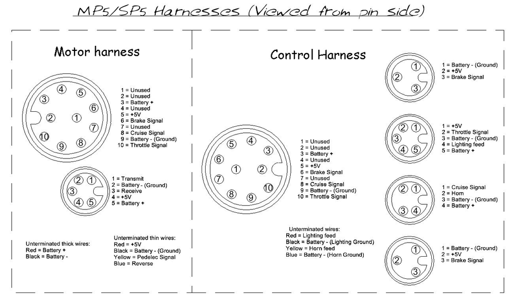

      Whew ..Thanks Alan ..That's a BUNCH of help .. I will take the front wheel apart later this week ..Just to nice outside ..I ride in the morning and evening ..(usually) ..
         I was thinking this Crystilyte module uses the same 3 wires the MP5 does ... Found the perfect plug on Amazon ..from your help .... Is this a waste of time ? ..can I actually destroy/hurt something trying this .. I like the cruise .."Try" to set it for 7 mph and then use the gears to keep some pressure on the petals to get a "Little" exercise .... The speed can be hard (Poor Me) to set sometimes ...while bouncing along ... My thought was the crystalyte module could adjust the speed up or down a little ... I have seen posts that say it doesn't adjust the speed much and others that say each speed adjustment is "more than a Little" ... Do you have any experience with this ..Stinks if I cannot at least try it ...$56 bucks with shipping ..Oh well Hobbys aren't always cheap ..
        Thank You so much for your help ... Once I get this offset wheel thing settled either way I will stop bugging you so much .. I really like this Kit but just cannot seem to leave this offset wheel alone .. It works fine ..Just like to try it with the wheel centered ...

      Here is the page that gave me the idea ..both switches use the same 3 wires ..different colors but described as the same thing ..the MP5 has an extra wire for the horn and the crystilyte has 1 that just says ..."not used" ..
      I totally understand if it wont work ..like trying to put a Chevy turn signal switch in a Ford .. Different technology ... Thanks again for all your help .... I'm sorry but I can't find anyone or a forum with the help you give ...   https://electricbike.com/forum/forum/main-forum/general-discussions/91876-electronic-throttle-lock-with-brake-release-and-slight-power-adjustability
Re: Offset Front Wheel ...
« Reply #17 on: August 02, 2022, 01:03:03 AM »
Don, I'm not sure where you've seen "both switches use the same 3 wires ..different colors but described as the same thing", as this is certainly not the case.
The MP5 4 pin Horn/Cruise switch connector only contains one of the four required wires for the Crystalyte cruise control (the ground wire).
It does not have a +5V wire.
It does not have a throttle signal wire.
It does not have a brake signal wire.
This is why you do not need a four pin Higo connector as you cannot simply connect the Crystalyte cruise control to the MP5's 4 pin connector.
Of the four wires that the Crystalyte cruise control needs to connect into the Magic Pie 5 wiring, three are located in the 5 pin throttle connector (Throttle signal, Ground and +5V) and one in the 3 pin brake connector (Brake signal):
Although all four of the required wires can be found in the the MP5's main harness 10 pin connector, I have been unable to find any 10 pin plugs and sockets that would match the MP5 harness connectors.
It look like connecting that cruise control to the Magic Pie wiring harness is not going to be straightforward, and it could require cutting open the existing MP5 wiring to make the required connections.
It may be possible to solder the three throttle wires directly into the MP5's throttle unit or splice them into the throttle cable to get the cruise control to function, but without the brake signal connection it would have to be cancelled manually every time it was used, or it would automatically resume at the previously set cruising speed when the brakes were released.
I haven't tried a Crystalyte cruise control, but you can see one being used in this video, but I don't know if it would behave the same with a Magic Pie controller.  :-\
