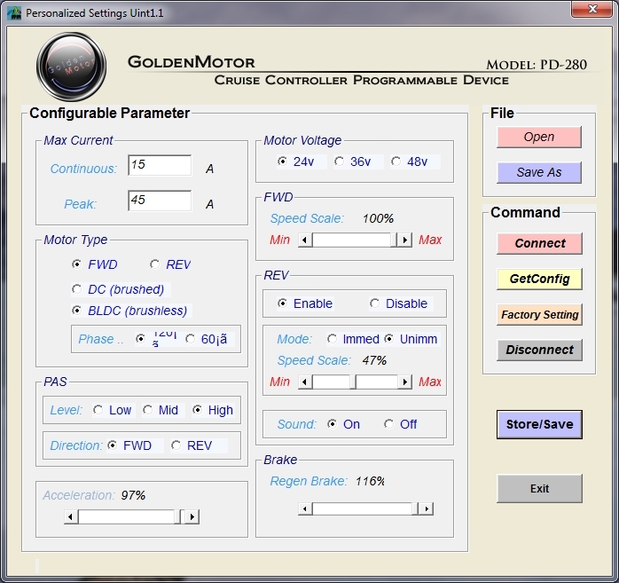

I have a problem with the speed limit on my Magic Pie 5.
I cannot change it from default 380. Everything else changes, not speed limit.
But the motor cuts off at 200 rpm ca 20km/h.
Any tips what to do?
I have tried different versions of the software.

The problem is I cannot change the rpm limit. It is 380 by default. And it changes back to default after downloading.
But even if it says 380, the bike only does 200rpm.

I have tried both usb and bluetooth. I have also tried different versions of the software.
I have 48v, and the acceleration is pretty good.
The log says
max current  26,2
mac volt 54,2
max m-speed 227

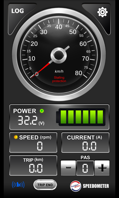

Sam, although the battery voltage (input voltage) will ultimately govern the absolute maximum rpm of the motor, on the earlier controllers there was a "FWD speed Scale" setting to allow users to set the maximum speed (rpm) to a lower value if required:
How do I see the input voltage.
Thor, the input voltage that Sam was referring to is actually the battery voltage, which can be seen on the Bluetooth display next to the battery gauge:
It will be interesting to see if the controller update makes a difference.

The voltage is now 52,6.
It does feel like everything work like it should, except the max rpm. I had 15-20 km/h up a steep hill. And the acceleration is good.

according to all I know about the (GM) BLDC controller (up to the MP4) this function is done via the input voltage, not some controller setting (you could limit somehow).
Hi Alan
that's exactly what I wanted to express: the Vin Limits the RPM whatever you set, but the internal RPM/throttle limit (that's what he could not change for whatever reason) should not be fixed.
