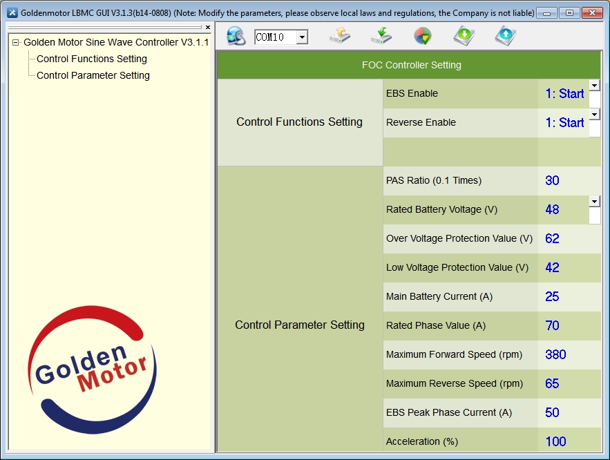

The default settings should be as shown below:
So it should currently be set at 48V and 25Amps.
The new controller should cure the problem and allow you to almost double your top speed!  ;)
It's good to hear it is now running at the correct high speed with the new controller.
