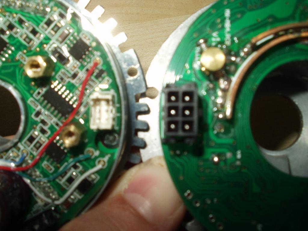

I tried to take a photo comparing the difference in size between the hall sensor sockets to show how much smaller the new connector is but it came out a bit blurry:
Check out Gary's video for more information.
« Last Edit: July 05, 2017, 04:42:20 PM by Bikemad »
Re: Magic Pie 4 (Vector Control)
« Reply #5 on: August 02, 2014, 05:23:43 PM »
Hey, it looks like I better drop Gary a line.  The quality improvements are obvious, even from the video.  The connector change and the conformal coating on the circuit board are huge improvements to the reliability problems I have complained about.  Thanks for the link to the video.
