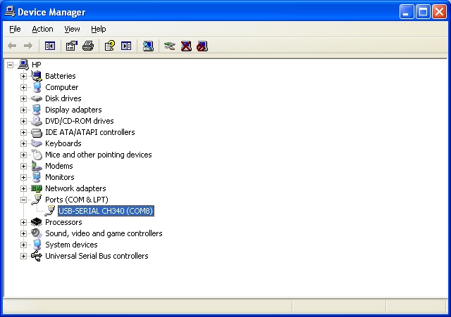

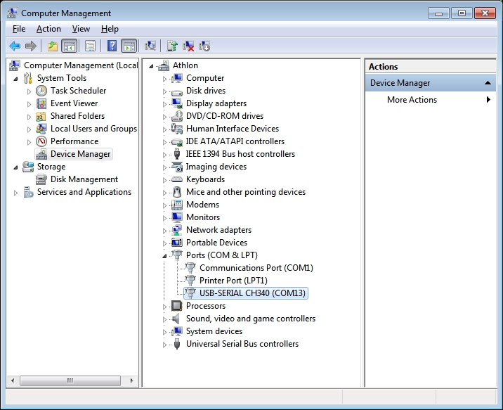

« Reply #5 on: August 01, 2014, 09:52:15 PM »
This is what I get on my Windows 7 64 bit machine:
And this is what I get on one of my XP laptops:
Have you tried rebooting your PC to see if it makes a difference?
Did either of the PCs indicate a new unrecognised USB device when you originally plugged the USB lead in, or do they not recognise anything when it's plugged in?

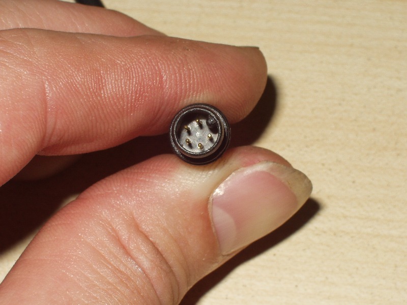

I see more than five pins on my adapter. Does yours look like this?
Re: Programming the Vector Controller
« Reply #7 on: August 01, 2014, 11:49:24 PM »
Unfortunately not, that looks like the ten pin main harness connector, my USB lead looks like this:
And this is the connector on the motor harness that it plugs into:
You don't need to unplug the main harness to connect the USB lead on my vector controllers like you had to on the earlier ones.
