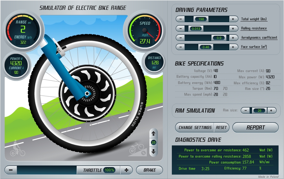

I work in the field of electric bikes: http://www.maxev.pl/, and I have some programming knowledge. I created an online application to simulate electric bike.
http://www.electricbikesimulator.com/
Simulator allows for an estimation of the range of an electric bike in real time. It can simulate the acceleration of the vehicle, driving up the hill, different speeds, the weight of the vehicle, the coefficient of rolling resistance (tire type, tire pressure, surface type), the coefficient of aerodynamic bicycle rider front surface, and the size of the wheel.
I used MagicPie because the engine looks nicely when turning.
I created this application to show my customers what the factors are range of the ebike. At the beginning I wanted to use the simulator only in my shop but I decided to share it with others on a separate website.
Many people have already tested the simulator and the results do not differ from the reality of more than 90%.
What do you think about my app?

« Reply #5 on: February 23, 2013, 05:17:55 PM »
According to the simulator, with all the same settings besides the battery, the bike will go exactly twice distance with 48V comparing it to 24V battery (same capacitance).
Does this happen in the real world as well?

I said the same system with same conditions on the  same road... The only difference is the battery... Case#1 is 48V10A battery, Case#2 is the same battery, but split to two batteries (2x24V10A). Will the bike be able to cover the same distance or it will be different for two batteries?
Offline Bartek
  • Posts: 6
Re: Electric Bike Range Simulator
« Reply #10 on: February 23, 2013, 08:02:38 PM »
I think, for the system 48V10Ah distance will be longer with the same speed as the 2x24V10Ah.
If You ride 25 km/h on 24V, You ride on 100% max speed for kit. But when You ride 25 km/h on 48V You ride on 55-60% max speed.
Look for the efficiency graph for 24 / 48: http://www.goldenmotor.com/magicpie/MP-performance%20curve%2024V.pdf / http://www.goldenmotor.com/magicpie/MP-performance%20curve%2048V.pdf
Efficiency is higher for 55-60% max speed 48V than 100% max speed 24V.

Two 24V10AH batteries in series gives you 48V10AH or exactly the same as one 48V10AH battery. Same distance. Same speed.(give or take a bit)
Two 24V10AH batteries in parallel gives you 24V20AH. Half speed and double the distance (give or take a bit)
I have three 48V10AH batteries in parallel on my eBike so I go three times the distance of one 48V10AH.(give or take a bit)
