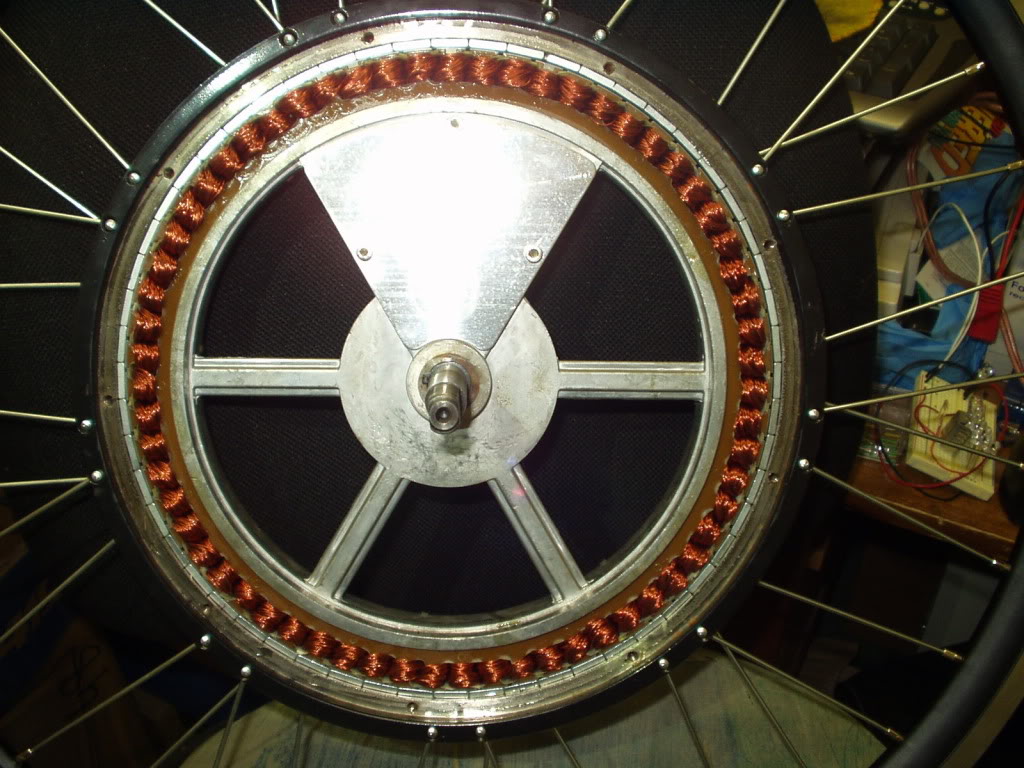

Thanks for the great photos.  It really helps me to understand the construction of the MP3.
Dennis, those photos (mine and Avantgarder's) were of the MPII, not the MPIII.
The stator inside the MPIII looks like this:
Right Hand Side.
Left Hand Side
The Left Hand side cover with the large bearing locates over the controller housing part of the stator, instead of the axle:
I hope this helps to clarify the main difference between the two motors.
