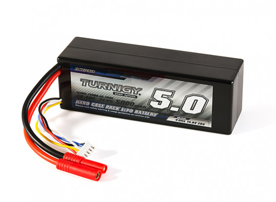

If the cells are perfectly matched, they will normally discharge at approximately the same rate.
I use 5000mAh Turnigy LiPo packs and the cell voltages always seem to stay nice and even.
When I put them on charge after use, the cells are usually within ±0.01V of one another, both at the beginning of the charge and at the end of it.
I'm guessing that when the packs are assembled at the factory, the individual cells are matched up with similar cells.

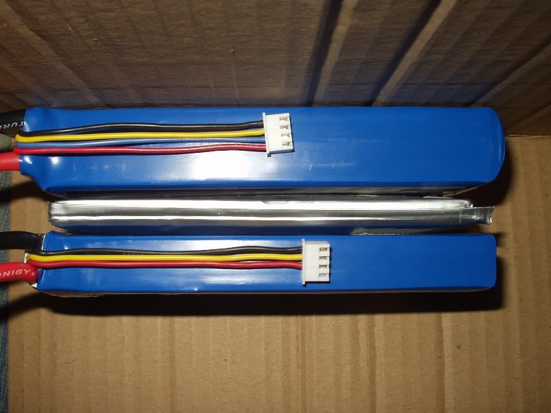

One of my original packs was faulty, so I dismantled it and removed the faulty (Puffed up and low voltage) cell, converting it from a 3s to a 2s pack.
The individual cells each had a sticker with two numbers on, and the cell I removed was marked 5300 and 5338 (see attachment below).
I don't know whether they test each cell twice, or whether one is the discharge capacity and the other is the amount taken to fully recharge it, but presumably these figures are used to allow all the cells in each pack to be matched as closely as possible.
