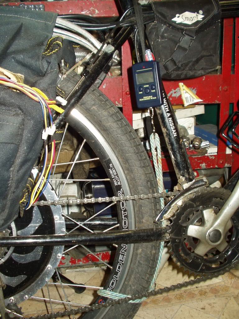

I once carried out a very simple stall test using a set of digital luggage scales attached by a piece of rope tied to the outer diameter of my tyre as shown here:
My modified Pie was drawing 65.94 Amps @ 25.6V (1,694 Watts) and although the controller cut the power before the luggage scales had time to lock the reading, I was able to read a reading of at least 28kgs/61Lbs of force on a couple of the tests, which I worked out to be around 93Nm of torque!
If this force is exerted on a 10mm deep dropout the lateral force acting upon the end of the dropouts by the edges of the flats is probably around 950kg (475 kg on each end of the axle).

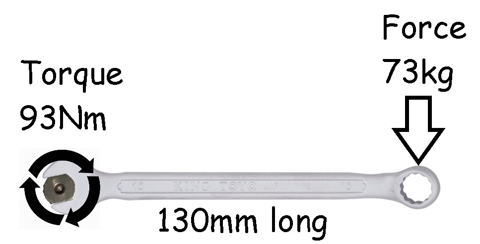

To visualise this amount of torque, if you were to place a 130mm long 10mm spanner onto the flats of the axle, you would have to apply a force of 73kg (160lbs or 11.5 stone) on the opposite end of the spanner to produce 93Nm of torque!
My modified controller would draw more than 65 Amps under load, so the motor produced more torque at low speed than a standard Magic Pie, but it should at least give you a rough idea of just how much torque is being transmitted through the axle.

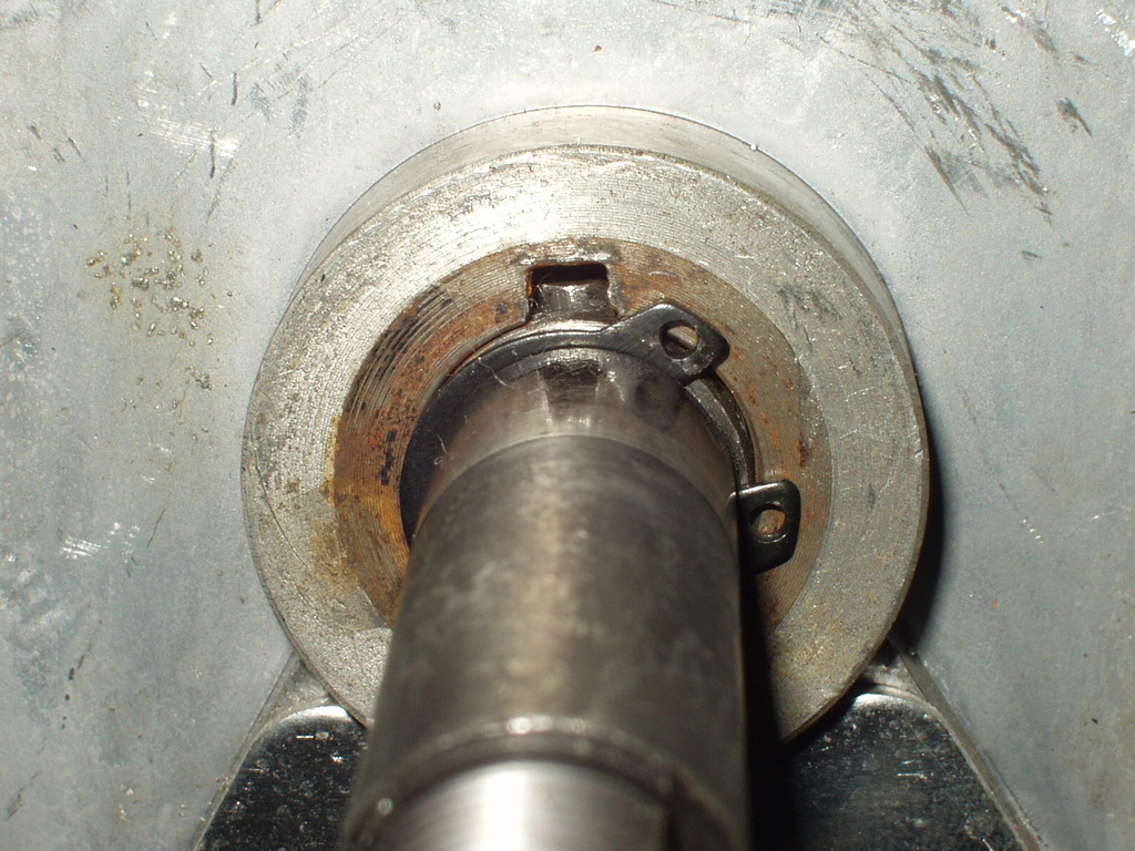

To remove the axle from the stator, you will need to remove the circlip shown below, as well as removing the controller from the opposite side.
If the axle is loose enough inside the stator to clonk under acceleration and braking, it should be relatively easily to drift out using a wooden mallet or a hammer with a block of wood placed on the end of the axle to prevent damage to the threads etc.
My MPIII axle was extremely tight and did not have any movement whatsoever (unlike the Smart Pie in the video) and I had to place a steel tube over the axle up inside the controller housing to press directly against the centre of the stator, so I could drift the axle through it without damaging the stator assembly.
I ended up threading two nuts onto the exposed end of the axle and locked them together with the outer face of the outer nut flush with the end of the axle to give a larger area for the mallet to hit, as I had to whack it really hard before it eventually started to drift out.
A hydraulic press would have been the best tool to use, but I had to improvise as I don't have one of those. ::)

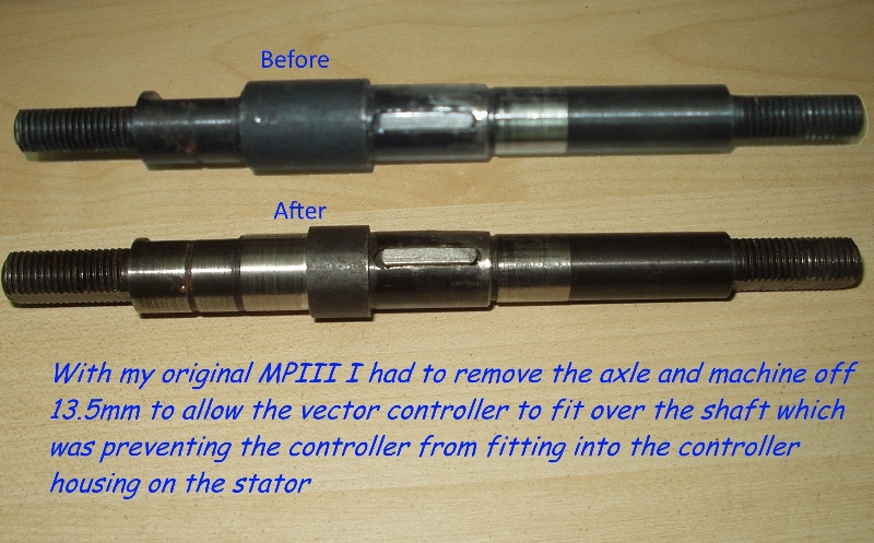

Your MP5 axle should look similar to the "After" version of my MPIII axle shown in the picture below:
You may be able to simply refit your axle using some Red Loctite Threadlocker to hopefully eliminate the unwanted movement.
