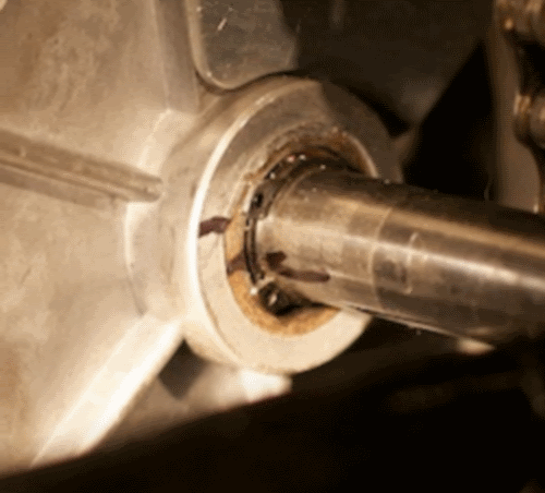

Andrew, I'm going to disagree with you regarding the key, because I think the key is fitted and is still locating the steel insert correctly onto the axle, but the aluminium stator casting appears to be slipping on the outside of the steel insert.
I can only see three possible reasons that could cause the problem you have:
  • The key has been dislodged and fallen out during the initial assembly process when the axle was pressed into the stator.
  • The key has sheared, allowing the stator to spin.
  • The aluminium stator casting has come detached from the steel insert, allowing it to spin.
I had a good look at your pictures and the key-way does not seem to be moving with the stator. I think this would have been easier for us to see if you had marked all the way across the joint as I originally suggested:
I would remove one of the side covers and mount the axle in a vice using soft jaws or scrap pieces of aluminium etc. to protect the axle. I would then use a marker pen to draw a line across the stator casting, over the steel insert containing the key-way and onto the axle, before trying to turn the stator by hand to see if anything moves where it shouldn't.
The steel insert is most likely secured into the centre or the stator during the casting process as the molten aluminium flows around it and fills up the mould, if this is the case you're going to need a complete new stator assembly, or preferably a replacement hub.
If you can repeat the experiment again, but this time with the pen mark right across the joint between the steel insert and the stator (as indicated below) and take some more photos showing before and after, and it will hopefully show the movement between the stator and the insert much more clearly.

Good eye, Alan.
The stator is clearly rotating about the steel collar and axle.  Scarey.

Alan,
Apologies - I missed that - and you were correct. See photos.
Andrew
Re: Stator Failure
« Reply #12 on: April 03, 2012, 01:37:26 PM »
The stator is clearly rotating about the steel collar and axle.  Scary.
And here's the result of combining the two pictures:
A single image that clearly shows exactly where the movement is taking place, I think this will be clear in any language. ;)
« Last Edit: July 03, 2017, 10:58:32 PM by Bikemad »
Re: Magic Pie III 48V installation trouble
« Reply #13 on: April 03, 2012, 05:08:39 PM »
Nice work on the photo!  We all can easily see what is happening.
