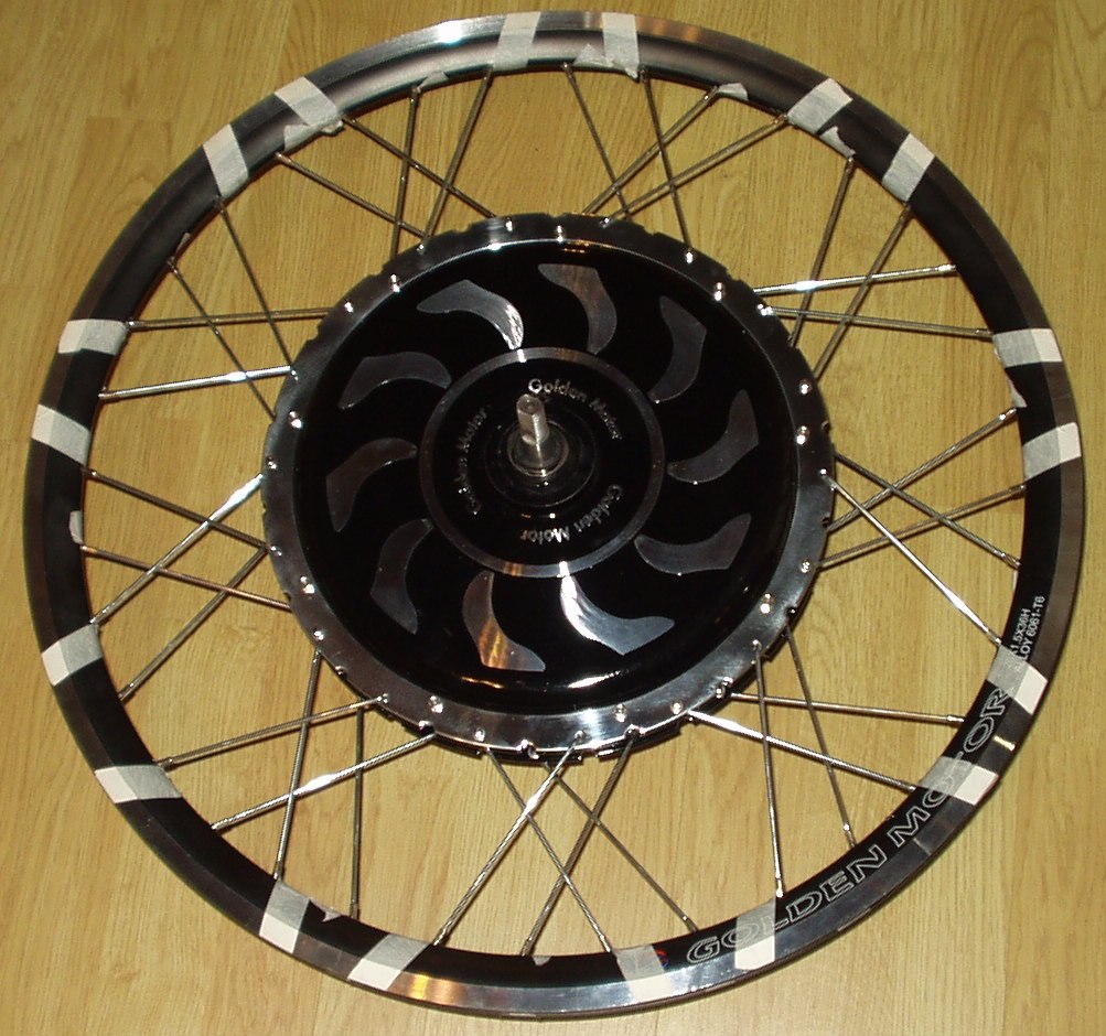

With the exception of my original Magic Pie that had the crossed spoke pattern, I always lace my hubmotor wheels with the heads of the spokes on the inside of the hub flanges, as this provides better support for the spoke elbow, enables the wheel to withstand stronger lateral forces, and will also allow a wider range of movement for correctly centring the rim:
If you have offset the wheel in the dropouts by adding an additional 3mm (1/8") thick washer on one end of the axle to provide clearance for a wider freewheel, you should only have to offset the rim by a maximum of 1.5mm (1/16") which is easily achieved by spoke adjustment alone with all spokes remaining at an acceptable tension.  ;)
