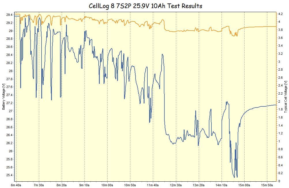

My wattmeter does not store the maximum voltage, but I do have a very useful alarm and data logging function on my CellLog 8S battery monitor:
I use this to monitor one half of the pack at a time, and I have never had the overvoltage alarm activate on either half.  ;)
Here is a graph showing the voltage variation throughout a test ride:
The high peaks show the regen voltage and the low bits show the voltage sag in the battery when the motor is under maximum load, and the highest cell voltage does not exceed 4.2V (which is the maximum permissible charging voltage for these LiPo cells).
Although I did manage to make the low voltage alarm sound a couple of times while on this ride with an old and weak 8 cell LiPo pack:
Some users occasionally ride their bikes without having a battery attached (or they sometimes have it attached, but leave switched off until needed), and this caused a lot of problems with the earlier controllers.
