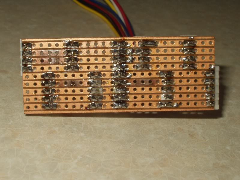

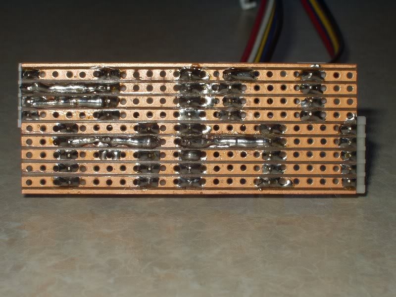

I did a similar thing once when I inadvertently connected two 7S2P packs in series while their balance leads were still plugged into the balance board in parallel.  One of the battery connections instantly vapourised as I started to push it in. Fortunately it didn't make a permanent contact or things would have been a lot worse.
I initially thought I had just ruined a battery connector, but I later discovered that it had also damaged several of the tracks on the rear of the balance board:
So I ended up bridging the gaps in the tracks with some unsightly soldering :
