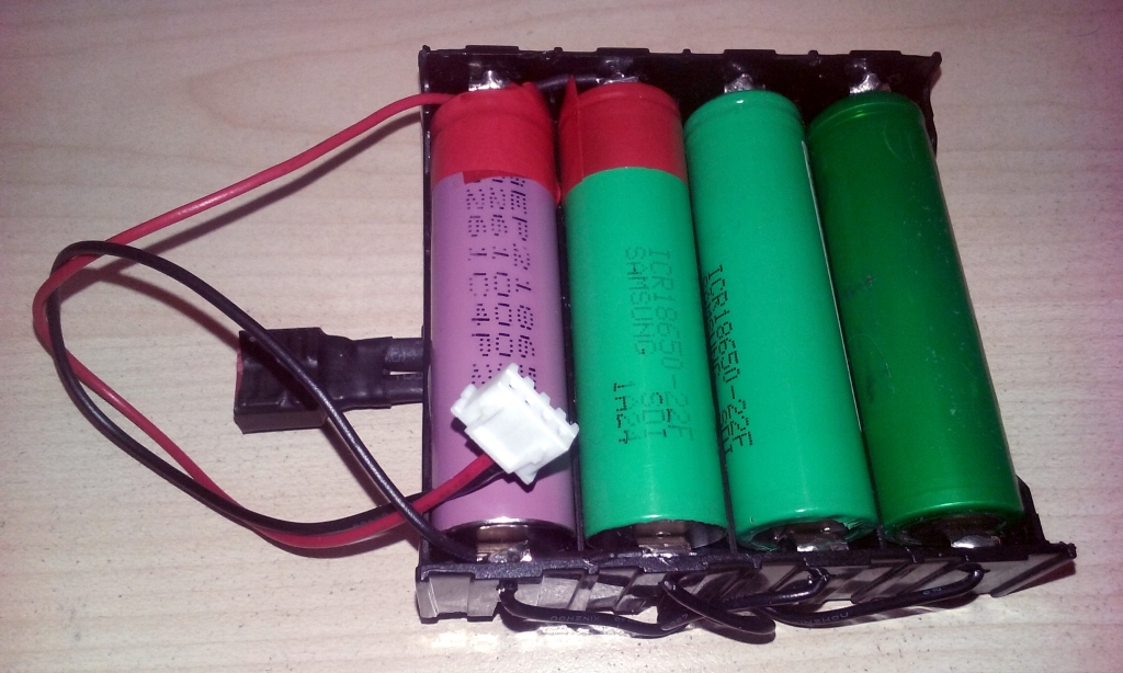

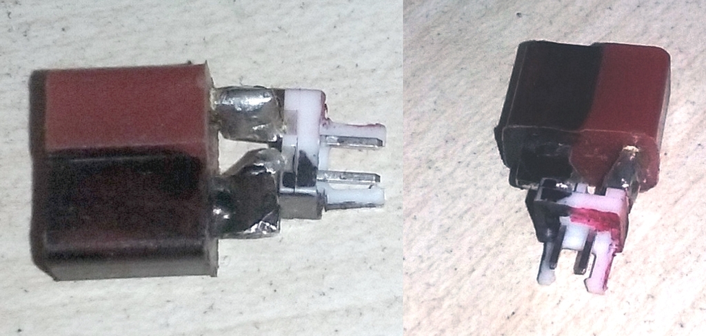

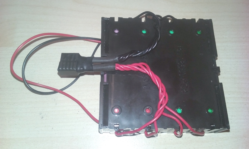

I have an adapter made by soldering a 2 pin JST-XH connector to a Deans style "T" connector which plugs onto the output lead on my iMax B8 charger to allow single cell charging or discharging at up to 3 Amps through the balance lead connector.
Unfortunately the voltage reading on the charger is quite a bit lower than the actual cell voltage so I have to manually monitor it with a voltmeter to prevent overcharging.
I can greatly reduce the voltage difference (which is very noticeable with higher current) by adding a separate balance lead as shown on this 4 cell parallel charge unit I constructed for charging recycled 18650 laptop cells which I then use in LED torches etc.:
With this setup I can charge up to 4 cells at a time using anything up to 7 Amps charging current and it doesn't overcharge them.
