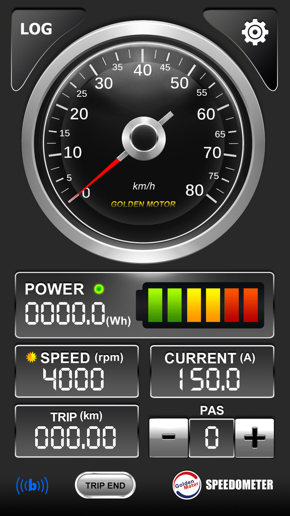

Yes, I have been told that as well but still have not seen any screens in the app supporting this so I go by my standard rule of not confirming anything I have not personally experienced. I do however see the settings Icon in the top right corner and am hopeful.

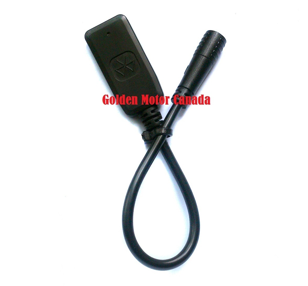

True. One connection at a time. I intend to zip tie the Bluetooth device to the bike. You can see from the picture it would be quite simple to do. Sorry about the logo. I don't know what I did with the original picture.
This does make the Bluetooth device the less expensive route not requiring both a smart display and USB cable. But then you have to buy a mount for the device on your bike.
I made a short video to help people understand their options. Click here to see the VIDEO
