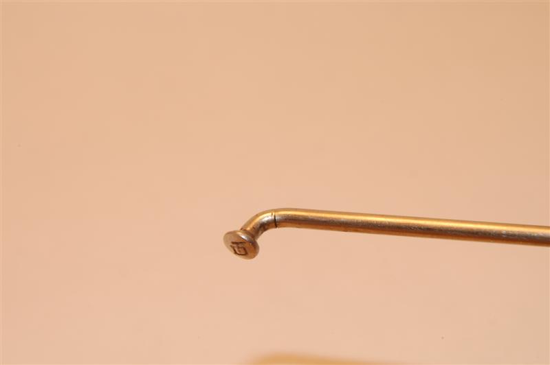

This also helps to alleviate flexing and fatigue of the unsupported spoke elbow at the flange attachment:
Alternatively, you can use spoke washers under the heads of the spokes to eliminate the gaps:
Which should hopefully prevent this from happening:
