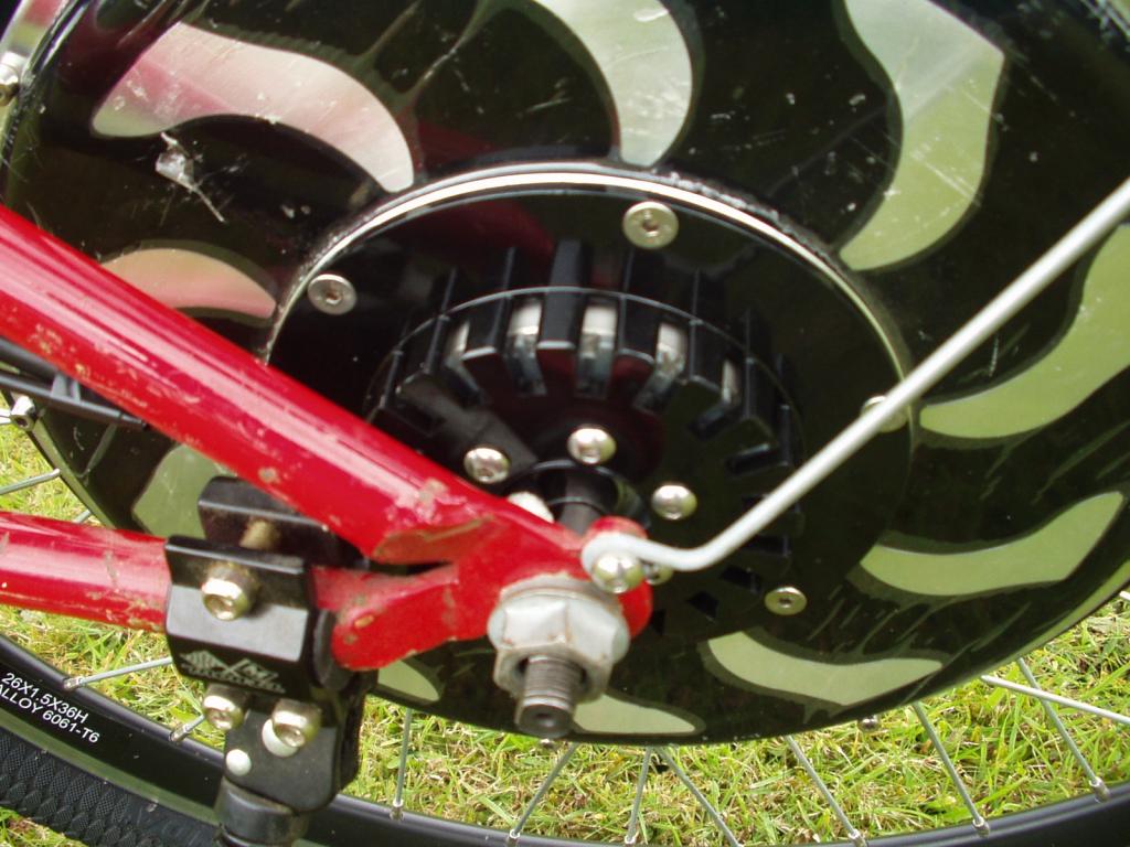

The serial number is on a sticker attached to the controller:
Unfortunately it is located inside the cooling fan assembly and it may not be possible to read without removing the fan casting:
« Last Edit: July 02, 2017, 10:11:26 PM by Bikemad »
