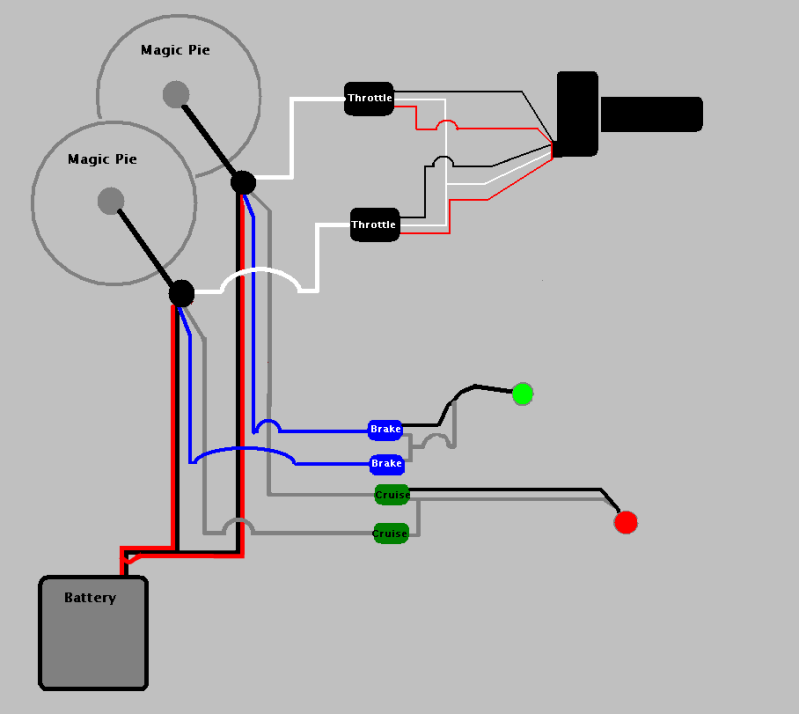

Here's a diagram that Leslie drew up showing most of the connections on a dual pie circuit:
If you could post some pictures of the harness and connectors, we might be able to work out where the lights are supposed to connect.
This lighting diagram might help:
Sometimes, the switch on the throttle is used for reverse, but I don't know if the switch on the dual pie harness is wired for reverse or for the lights.

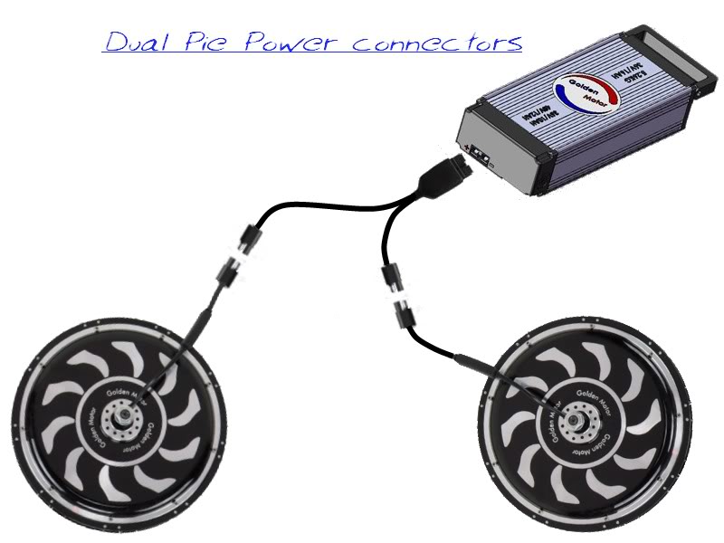

This guy was assuming there would need to be power directly to both motors, something like this:
Although I'm not sure posting the image is working here..  He's requesting another of the battery to motor cables (with the plug which has a male and female point on each side)
But it sounds like the power only needs to go to one wheel and will be carries onto the other motor through the wiring harness, great!

Hi RevBecca,
With one battery the power from the battery must be split to both motors.
Similar to this:

I would expect a "Y" type of power lead with a single battery connector fitted to one end, and two power supply cables on the other (one for each of the motors).
Hmm, I'm confused as to which part of my opinion was not the whole truth.
To avoid any confusion, I produced the above diagram and inserted it into Gary's post to clarify what had previously been described by both myself and Gary, it was a direct visual interpretation of my initial reply.
