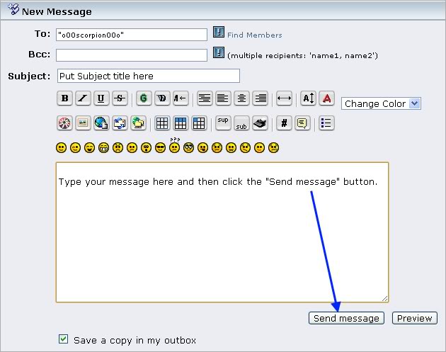

« Reply #21 on: September 30, 2011, 01:57:40 AM »
I would be interested but don't know how to PM you cos your mail is hidden
Fred, you don't need an email address to send a Personal Message, you simply click on the Personal Message icon below the member's avatar:
and then compose your message:
It's like posting on the forum, except it's private. ;)
