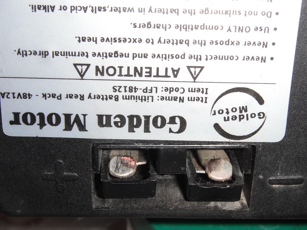

If there was a loose conection on the battery take a close look at the plug on the cable and in the battery. I have seen the plug fail and one contact moves back when you plug it in. this still crates a conection but not a very good one. The contacts should tell the story with marks from sparking. The image below shows the contact points in a battery. I suspect the battery cable plug is broken in this case and making bad contact. The image of the battery cable that was sent to me is unclear.
That being said the contacts could also look like this from plugging the battery in when it is switched on. Most people have the battery off when making a connection, but not all.

I took a closer look at the battery socket, and indeed, one connector was moved back. I disassembled battery. Inside everything looks good, solder is fine, no traces of sparks or burn-outs or something. One wire at charger side had hole in its insulation, I covered it with tape de bene esse. I fixed connector  and assembled battery back.
Well, no changes. I can say that max speed lowered as well, to say by 3-4km/h. If before I could make 42-43 km/h on flat, now it is ~39. I figured out the system - I can throttle well only if I get 21km/h already - then no problem, motor is able to speed up and to maintain speed.
