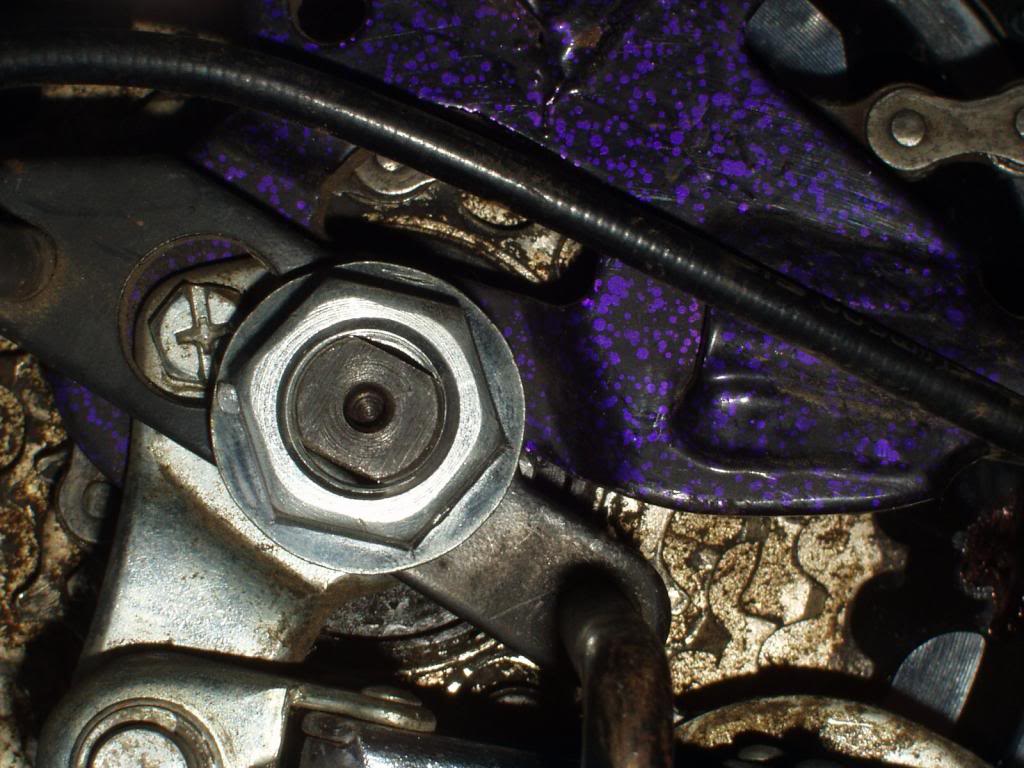

Ok I'm starting to think I might have a "dud" axle. I rethreaded the stripped section, and got brand new m14 1.5 nuts. I set my torque wrench to 40lbs exactly, checked and rechecked again.
I'm not even tightening the lug up on the stripped section anymore as I moved my torque arm to the other unstripped side of the axle so I'm tightening up where the torque arm used to be on clean threads and it stripped again. I didn't even get the click to 40lbs and I can tell it's stripped. It just kept spinning and didn't get any tighter.
I stopped and set the torque arm to 30lbs and got a click, 32 click, 34 one 1/4 turn then click, 36 2 1/4 turns click, 38 3 1/4 turns no click.
So it stripped somewhere around 36 - 38 lbs
I put my other new nut tight against the stripped nut and managed to get it to 40lbs with both combined but now I know the next time I need to pull that tire I'm gonna have to deal with this again  >:(
Is it possible I got a bad axle, maybe lower grade steel or something? stripping at 55lbs I can understand but 36 - 38lbs??

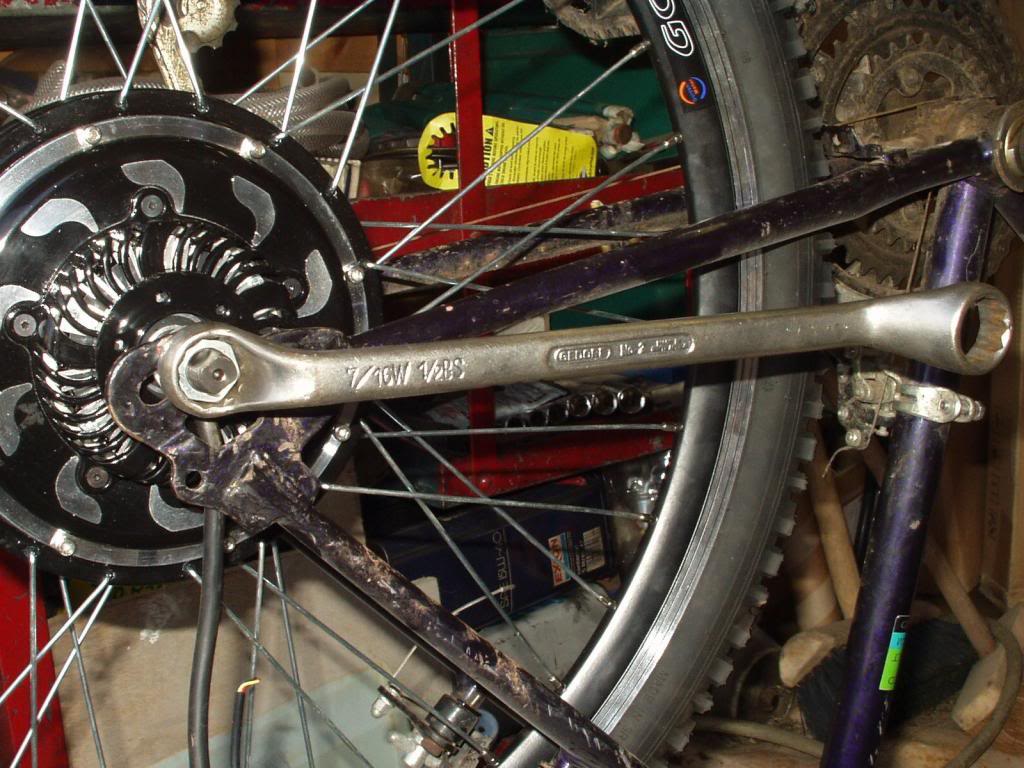

Here is my preferred tool for tightening the axle nuts, a 7/16 Whitworth ring spanner:
I would expect a standard Magic Pie to exert a maximum torque of around 50Nm through the axle, and most of this torsional force would be counteracted by the dropouts and the tabbed torque washers rather than the axle nuts.
Theoretically, the two axle nuts should be able to withstand this amount of torque without the assistance of the axle flats and torque washers etc., provided they were both tightened to at least 25Nm.
I therefore feel that the 39.5Nm, or 28.76 ft/lbs tightening torque calculated above should be more than adequate, especially when combined with the axle flats in the dropouts, torque washers and an additional torque arm.
