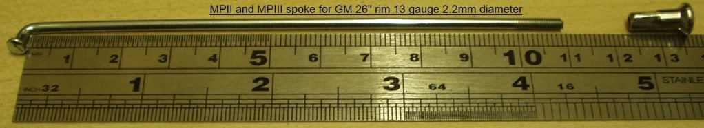

I tried to determine the ERD on a built up wheel and I reckon it is somewhere around 518mm on the 26" GM rim that I measured.
(The inside diameter is approximately 508mm and the 13mm long nipples only have ~8mm protruding from the inside of the rim.)
The factory fitted spokes are 110mm long when measured from the inside of the elbow:
