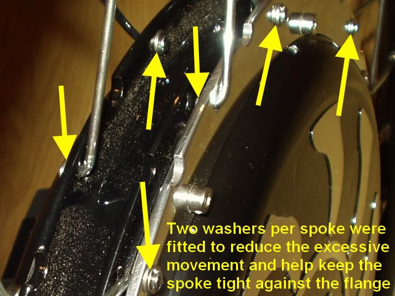

Which end of the spoke has broken, is it the threaded end or the bend at the hub end?
I'm guessing it's the bend at the hub flange:
Quote from:  Justin Lemire-Elmore (ebikes.ca)
A common reason for spokes to fail on hub motors isn't because the motor puts extra strain on the spokes, or because the spokes aren't a thick enough gauge, it's because of fatigue failure from spokes that aren't held snug against the flange. If the spoke bend radius is too large or too far from the head, then it can flex up and down at the bend with each wheel rotation, eventually causing it to crack and fail.
This problem has been legendary with overseas built hub motors, and we had some Crystalyte shipments where about half the customers would experience spoke breakage on a recurring basis. Ideally the distance between the head and the bend in your spoke will match the thickness of the hub flange, and you won't have problems. But if not, there are two ways to address the situation. One is to insert a washer under the spoke head. The second way is to lace the wheel in an over/under pattern, such that the spoke tension compresses the bend part of the spoke into the flange.
I had to modify my original Magic Pie to enable the tyre to be correctly centred in the frame, and during the rebuild I decided to fit small stainless steel washers to all of my spokes to eliminate the excessive movement and hopefully prevent my spokes from breaking, and I'm very pleased that I have not had any trouble with spokes working loose or breaking since the flange modification was done well over a year ago:
« Last Edit: June 30, 2017, 10:40:35 PM by Bikemad »

Yes it was the elbow / flange end on all 3 counts. I am currently running with one spoke missing until weekend :P I've got a full set of DT Swiss Champion stainless on there way.
Your advice is very much appreciated and of course will take heed, already thinking that B&Q will be just the place for a bag of washers that size  :)

I notice from your picture that flange position alternates from facing in and then facing out - is ther a set pattern for that? To be honest I did not ntice this when I replaced 2 the other day and just assumed that the end of the spoke flange end face away from the wheel instead of some of them facing though and across the other side (if that make sense?)

I notice from your picture that flange position alternates from facing in and then facing out - is ther a set pattern for that? To be honest I did not notice this when I replaced 2 the other day and just assumed that the end of the spoke flange end face away from the wheel instead of some of them facing though and across the other side (if that make sense?)
Webby, I'm not sure if B&Q will stock stainless steel washers in that size, I found mine in a local building supplies and tools shop who keep a pretty good range of nuts, bolts & fasteners etc.
My spokes alternate because I have the early MkI Pie with cross over spokes (which unfortunately produces an excessive spoke/rim angle and curved spokes due to the large hub diameter - see attachment below). On the later MkII Pie's, like yours, the spokes all exit from on the inside of the flange and have the heads visible on the outside.
For anyone using a spoked Magic Pie on a trike, it would be more able to withstand the greater lateral forces encountered when cornering if the heads were on the inside and the spokes wrapped around the outside of the flange, but I guess the spokes might need to be slightly longer to allow for that. ::)
