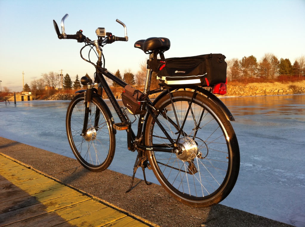

« Reply #20 on: February 27, 2011, 04:42:47 PM »
More Progress!

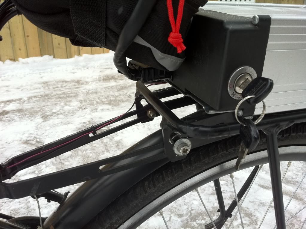

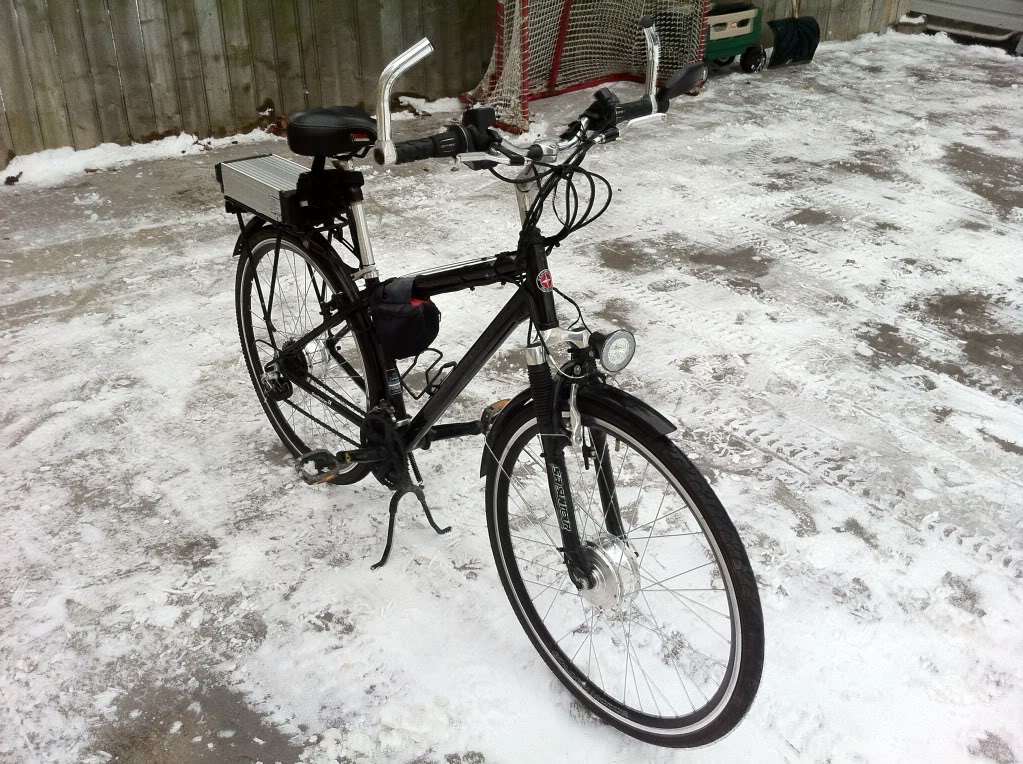

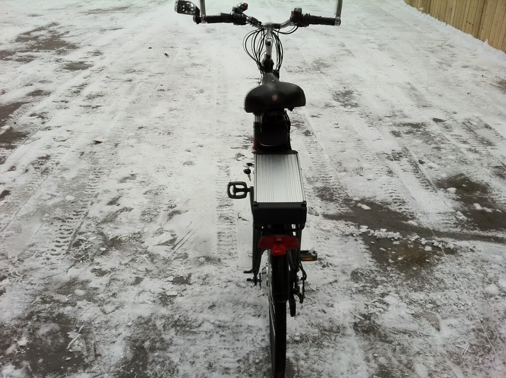

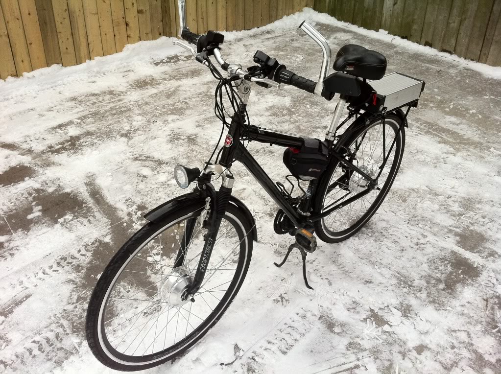

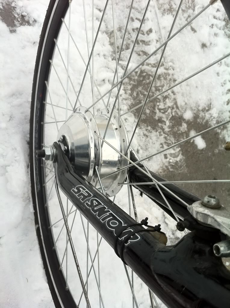

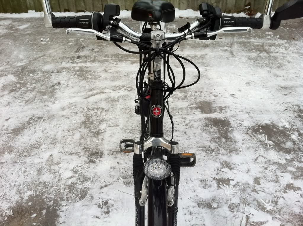

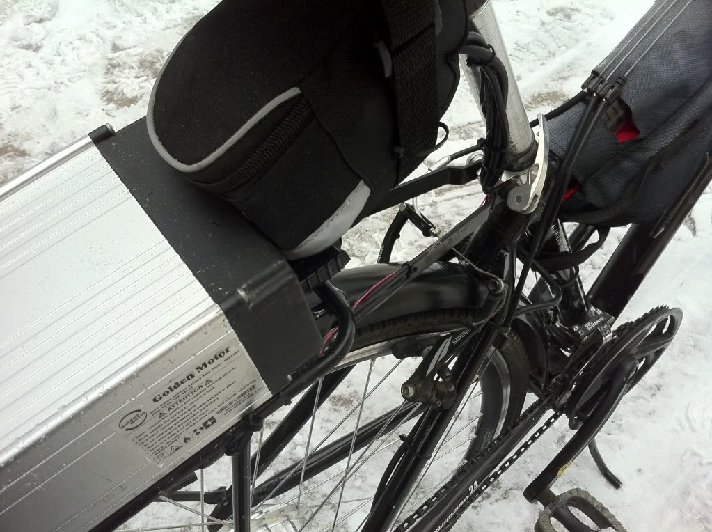

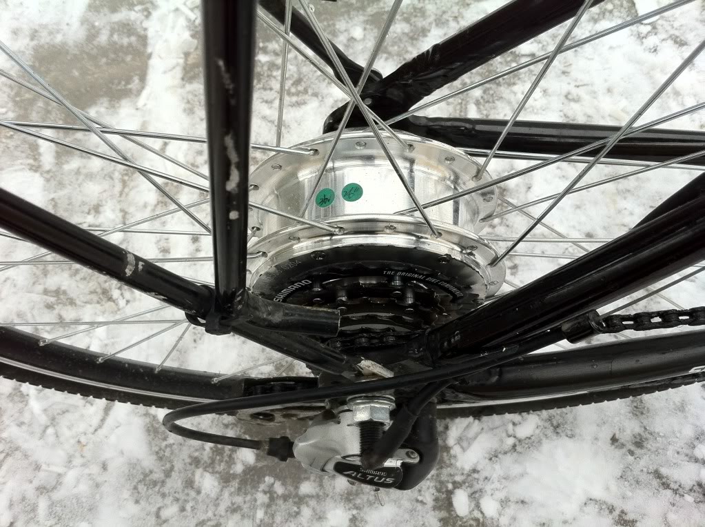

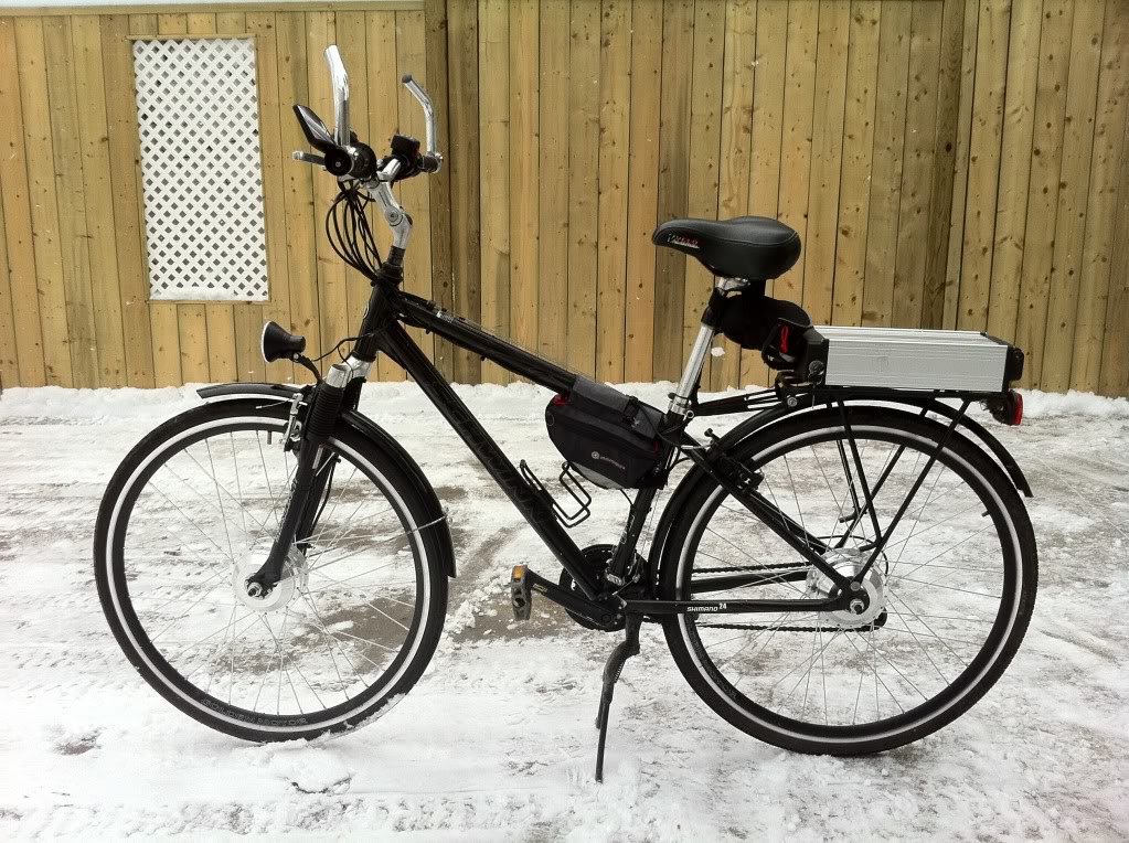

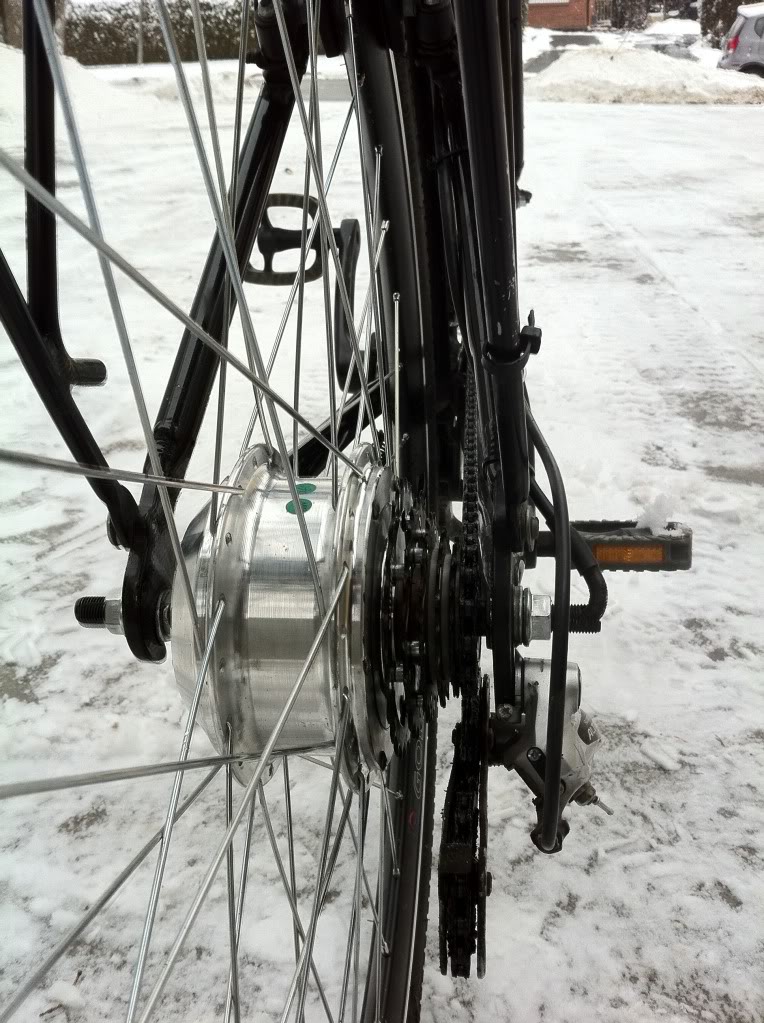

Still some minor wire cleanup to go but things are coming together nicely. Still have to get all those wires at the fron to the same length and wrap them in the curly wire wrap. Also going to get a nice schwinn rack bag and cut the bottom ope so I can pull it down over the battery. Should make it invisable. If only the snow would go away so I can take it out without getting it dirty!

Nice and tidy setup ;)  Are the controllers in the frame bag?
Get us some performance stats as soon as you can.  I will be looking into getting a mini dual kit some time soon.
« Last Edit: February 27, 2011, 04:58:41 PM by Andrew »
Re: Dual Mini 700 c. It Begins! I can't sit on my hands anylonger!!
« Reply #22 on: February 27, 2011, 05:12:58 PM »
The triangle frame bag has one controller and all the access wire coiled up from the brake lever, throttle and buttons. It packed pretty tight but fits. The second controller is in the bag under the seat. Plenty of room there. Once again I am amazed at how quickly it is to wire up a dual drive. I have everything wired pemanenty now with cruise, brakelever and throttle wires all split. I even wired up the horn and the lights. I have a pedelec on this bike as well and plugged it into one controller. I just realized I will still have to split that for it to work properly. Sheesh just when you think your done! All the holes in the bags I have cut will be hot glued shut when I finalize the wiring clean up. I am really liking this bike now. Its kind of like when you buy a new car. When your not driving it you park it in the driveway and sit there with a few refreshments and just admire it :)

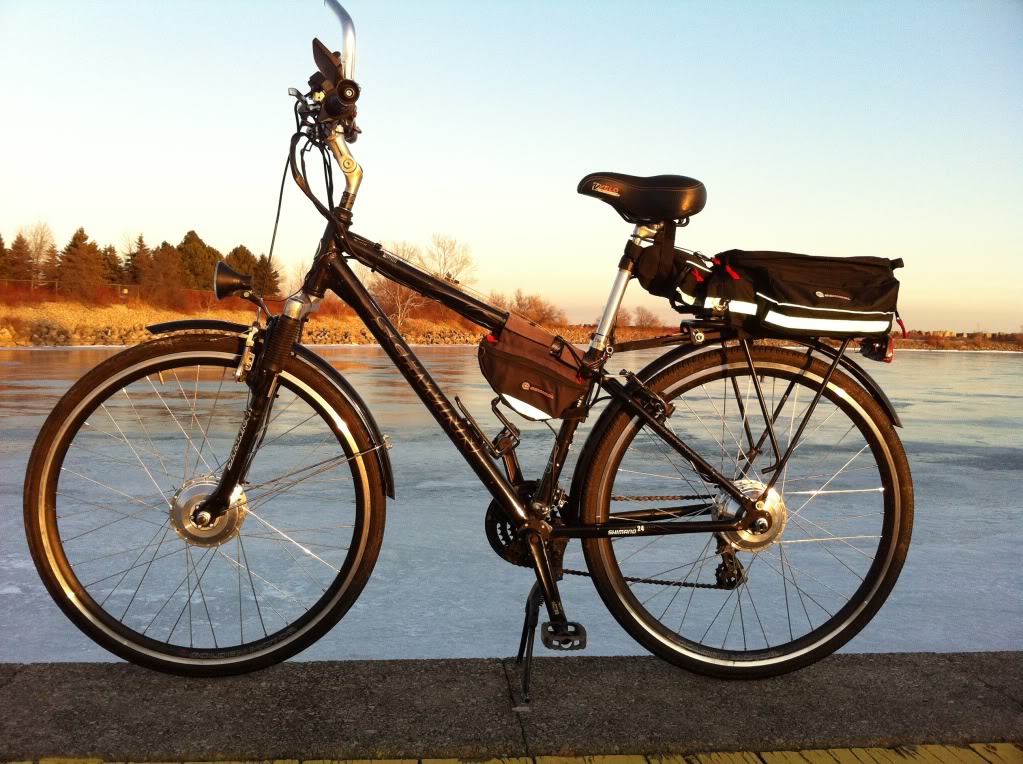

Heres a walkaround video.
http://www.youtube.com/watch?v=o8AlUYfWf6o
« Reply #24 on: February 27, 2011, 06:48:26 PM »
nice looking frame you have there. I can tell from the walk around how pleased you are with the neatness of the build :)  It's important to me how integrated the kit is on a bike. It should be part of the bike not something attached to the bike ,,, if that makes sense?

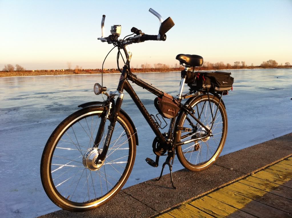

The GolSchwinn Dualini Stealth!

Still no hard Data, but they do seem fast!
A little peddling at take off then the rest the mini's are haulin azz!
