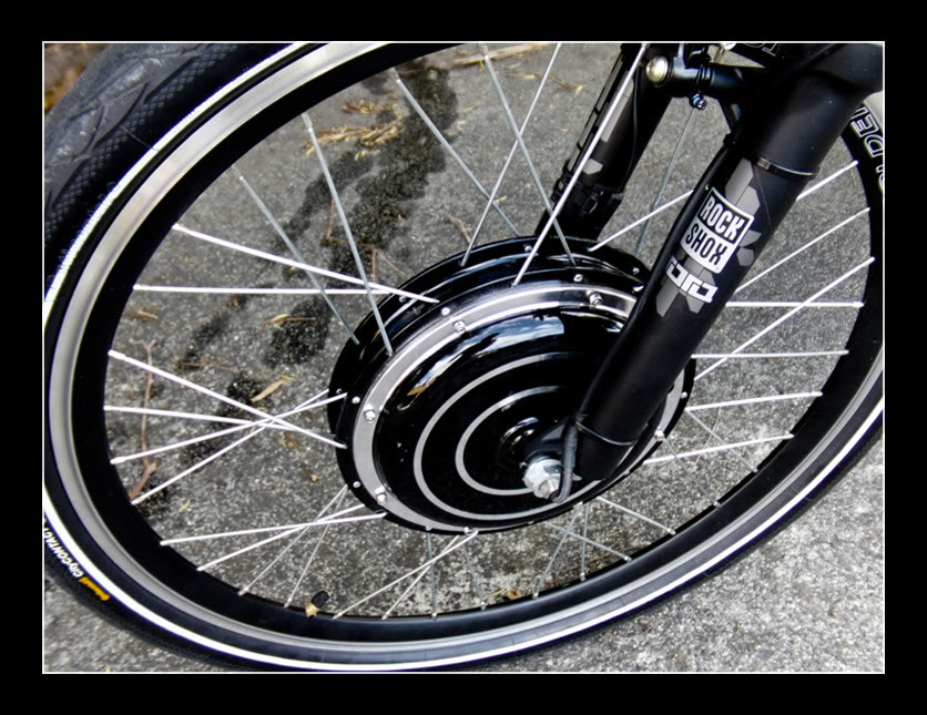

The wires should exit from the left hand side.
Check out this post for some more useful information on a scooter conversion.
Re: Braking of HBS-48V1000W Solid 16" wheel
« Reply #5 on: September 02, 2010, 02:08:14 AM »
wire comes out the left hand side when siting on the bike facing forward, is that right?
That's correct!
You can see it clearly on Wayne's front wheel, picture taken from the left hand side of the bike:
