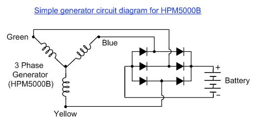

I just purchased a 72vdc HPM5000B to be used on an experimental wind turbine of my own design.
I would like to know what your large wire color codes are.
They are Green, Yellow and Blue.
I also assume since I am using this motor as a power generator to charge my battery bank, I will not need the small wire connector for anything.
I need to know which wire is positive, negative and ground.  I assume Green is ground!
Please Help.

Dan,
Wiring details for this motor can be found here: HPM5000B
The Green, Yellow and Blue thick wires are the three phase main power wires.
If you're using it as a wind generator you will require six heavy duty diodes (or a suitable rectifier unit) to rectify the AC voltage produced:
You will probably require some form of voltage regulator to prevent any overcharging of your storage batteries, but you will have to do a bit of research on that.

(I assume) the motor is a permanent magnet brushless three phase in-runner motor/generator? the 3 thick wires yellow (A), blue (B) and green (C) are the phase wires to the Y-connected stator winding (star point not accessible). The 3 thin wires yellow (U), blue (V) and green (W) are the Hall sensor signals and red (+5V) and black (GND) are the power supply for the Hall sensors.

Now, what you really need to do, would be to take a trip over to fieldlines.com, and read until your eyes starts to tear... :D It's also worth to take a look at their companion site, otherpower.com. These guys know things about generating power from pm generators that I suspect even the experts doesn't know... ;)
But in general, what you need, is a 'dump-load controller', not unlike Leslie described; a device that switches the batteries over to a load that are matched to the output of the windgen when the batteries reaches top-charge; the windgen should still be connected to the batteries.
Now, this applies to lead-acid batteries; for Lithium batteries, it might be a good idea to activate a kill-switch to the generator (connected between the gen and the diodes), when the batteries are fully charged...
Also, a manual kill-switch (a switch that shorts all the phases of the gen (mounted before the diodes)) are a good thing to have when storms hits you... ;) A runaway windmill are scary to be around... :D

Have you tested the motor with a rotor at all?
I suspect that you will have problems getting it to work as a windgen at all, sorry to say. The motor has a potentional to generate closer to 5kW, but that would be at 3600+ rpm. A rotorblade closer to 17-18 feet in 11-12m/s would be required to get that kind of power, and a rotor that size have a usual speed at 80-120rpm in such windspeeds. Gearing are usually out of the question for us tinkerers at those power levels, besides, it adds noise and reduces efficiency.
If you use a smaller rotor to get higher rpm, the rotor would probably never get out off stall...
Sorry, I don't mean to be pessimistic, but there are a lot of things to learn before managing to make a working windgen. :)
But a bit more on topic:
Being a 3-phase star-connected 'generator' (for your usage), you can calculate DC voltage (The voltage you get at a given rpm after rectifying all three phases) by measuring AC voltage between any 2 of the tree phase-wires. Multiply this voltage by 1.73 to get 3-phase AC voltage, and then multiply that with 1.41 to get rectified DC voltage.
 (1-phase AC *1.73) * 1.41 = DC out
Now, if you use a drill with a known top speed, and connect it to the motor and run it at full speed and measure the ac-voltage, you will have a very good idea on what speed you'd need for your voltage.
Cornelius, this was originally discussed in another topic back in August last year, and I indicated at the time that this motor was not ideal for a wind generator:
19.98 VAC at 2000 RPM
Dan,
If those figures are correct, your wind turbine would have to be geared up very high to spin the motor in excess of 7,200rpm in order to generate 72V.
Wind turbines don't like too much speed!
I think this motor is probably not the best choice for a wind turbine project.
If you're still interested, the original post can be seen here.
P.S. According to your figures, it should produce 48.73VDC @ 2000 rpm.
So, to produce the required 72VDC output would only require 3000 rpm not 7200. :o
