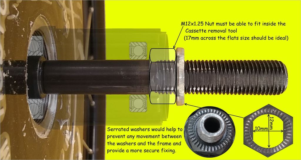

The axle thread on the Cassette version is only 12mm diameter, but I would expect the axle thread diameter of the freewheel version of the Magic Pie Edge to be 14mm, which is too big to allow the 12mm bi-hexagon shaped hole on the inside of the freehub body (and its outer bearing) to fit over it:
Please note, the axle threads in the above drawing have been extended to illustrate my proposed modifications to the original design.

Therefore, to convert your hub, I think you would have to replace the axle, nuts and washers, the R/H side cover and then obtain the correct threaded freehub unit to match.
