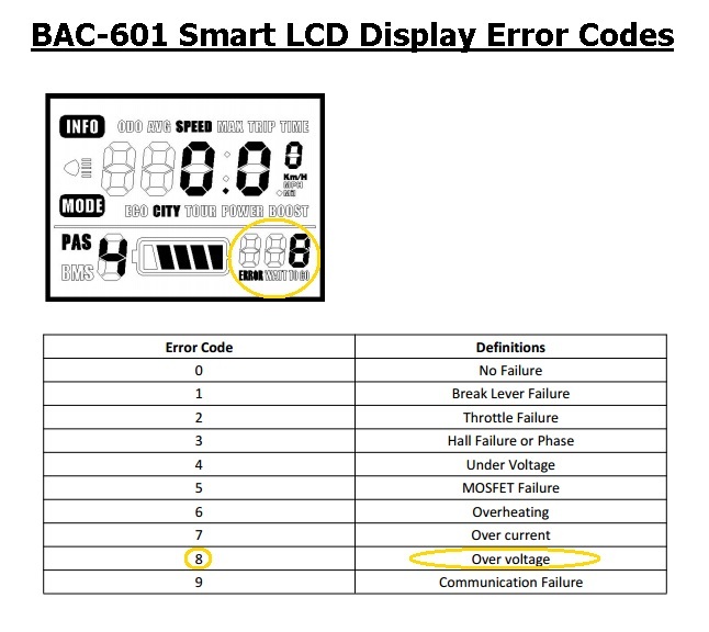

I have an early version of the BAC-601 Display and mine also loses all the trip information when power is turned off.  :(
The biggest problem I find with the BAC-601 Display unit is that it does not retain any of the trip data when the battery is turned off, the odometer is the only information that isn't lost.
But, I don't understand why yours isn't saving the odometer data. ???
I get the error code "1" on mine when either of the brake levers are operated, but I think the later displays show E65 instead, which simply shows that the EBS is active. (E85 might have been better for EBS).
The word "ERROR" is usually displayed to indicate an error code as shown above.
