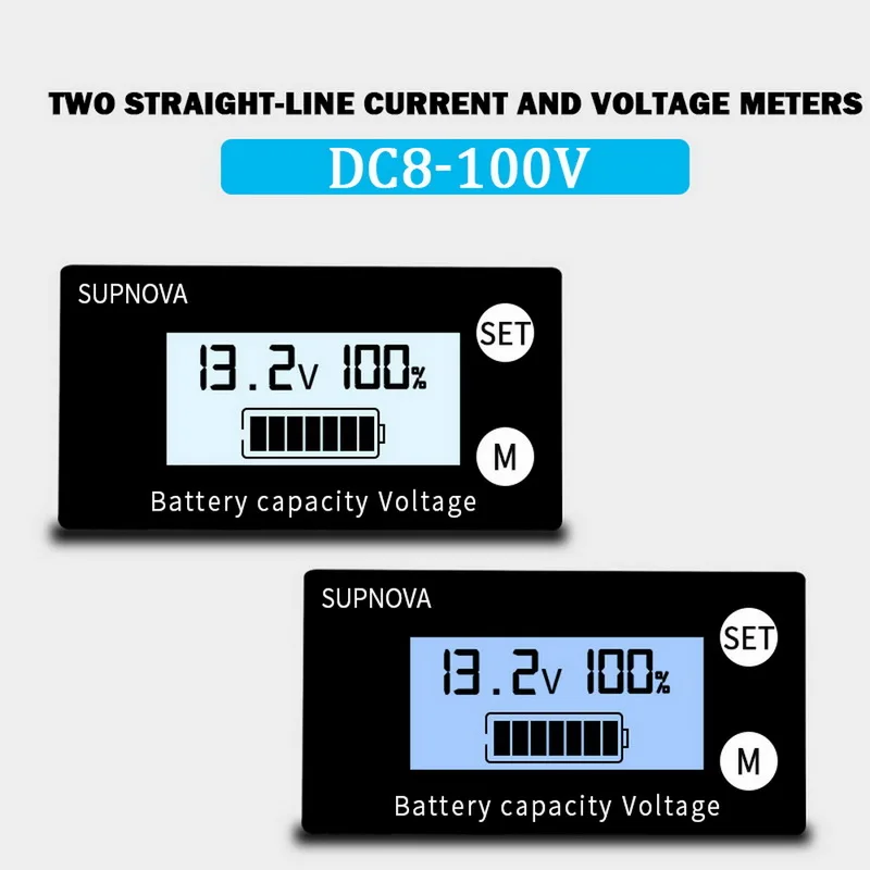

It is better for the battery if you don't let it go below 20% and also don't store it for long periods above 80%.
I use a cheap and simple battery capacity gauge to give a rough indication of the remaining battery capacity and I suggest that you try using one of these:
For your 52V battery you would need to set it to L14 (14 cell groups in series) for a typical lithium pack or F16 (16 cell groups in series) if yours is a LiFePO4 battery.

Thanks again for the help .... I got a digital voltmeter for the handlebars ...With the chart I found on here I can track the state of charge and the % used on each ride .. I'm thinking recharge at %35 ..Little afraid to let it go much lower ??? I have read where full charge for the first few cycles 3-4 to let the battery balance ...then 80% most of the time after that
