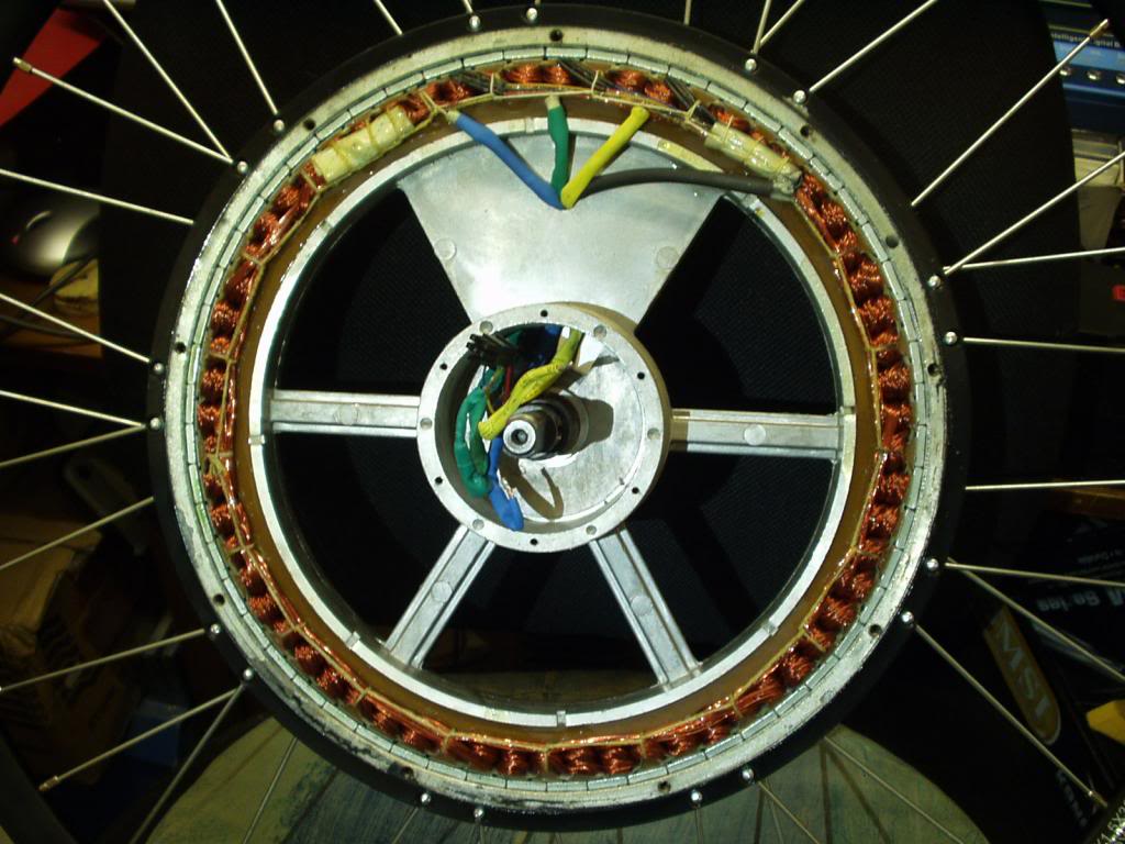

As you have already discovered, they are MPIIs not MPIIIs or MP4.
The later internal controllers (MPIII, MP4 and MP5) are not suitable for the MPII:
The MPII has the same stator and internal controller as the original Magic Pie:
MPIII, MP4 and MP5 has this style stator to accommodate the later style controller:
