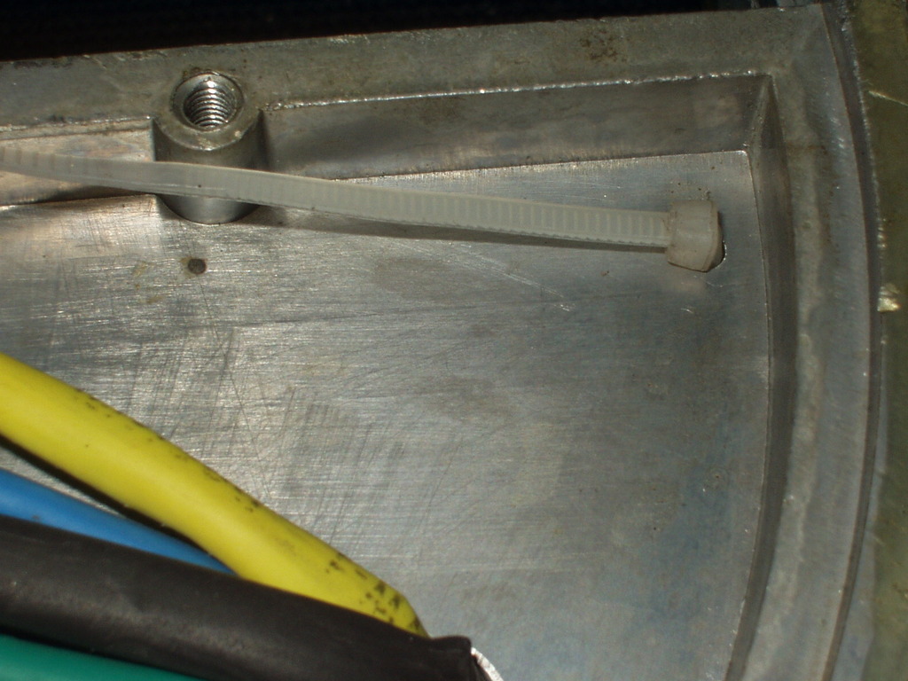

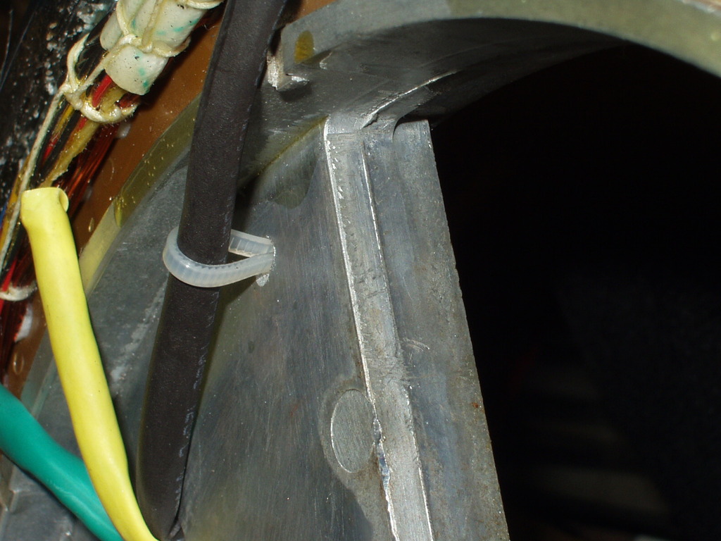

If the rubbing noise is still audible while pedalling, it could be the side cover rubbing against the black protective sheath on the Hall sensor wires inside the motor:
You can just see the circular rings on the inside of the cover of my MPIII where the cable had been gently rubbing against it:
I simply drilled a small hole in the stator to allow a cable tie to be used to hold the cable tight against the stator, which prevents it from rubbing against the inside of the side cover:
This is what it looks like from the other side of the stator (with the access plate removed).
