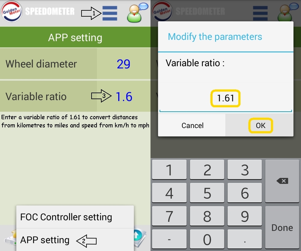

More testing today went very well plenty of power and speed, 40 mph very easy at 25 amps.
Are you sure that's not 40 km/h? As 40 mph seems to be a little on the optimistic side.  :-\
With the Bluetooth App, you can simply enter a variable ratio of 1.61 to simulate speed and distances in miles instead of km:
It will still have the units displayed as km and km/h, but the figures will actually relate to miles and miles per hour.
« Last Edit: July 02, 2017, 07:14:16 PM by Bikemad »

« Reply #34 on: May 14, 2017, 06:04:32 PM »
the display was showing 62km/hr with wheel diameter set at 26 just under 40 mph on flat did this for about 10 sec. I guess something could be off elsewhere I am happy with it though.
