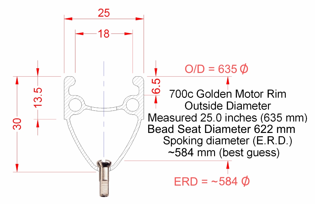

Here are the details for the GM 700c rim:
You will need to find a rim locally with the same Effective Rim Diameter (ERD) if you intend to reuse the same spokes.
A non-GM 700c rim may have a different ERD, which would require different length spokes.

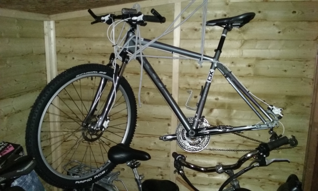

The standard GM 700c rim should be less prone to damage with a 29" x 2.4" tyre fitted (if there is suitable clearance within your frame):
I fitted a pair of 29" x 2.25" tyres to my 700c rims on my Felt QX to replace the standard 700-37c tyres:
The front tyre fitted fine:
But, the rear tyre was just too wide for the frame.  :(
I have since purchased a 29" x 2.1" tyre for the rear wheel, but have still not had chance to see if it will fit within the frame yet.  :-[
Check out this post for more information on spoke lengths and measuring the ERD.
I suggest that you apply some penetrating oil to each of the spoke threads in the meantime, as this should make it a lot easier to undo the nipples when you eventually decide to replace the rim.  ;)
