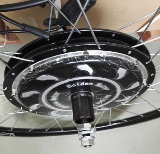

I received a pre-production cassette version of the Magic Pie Edge back in September 2015 and I was very concerned about the small amount of surface area available on the freewheel end of the axle where it pressed against the torque washer:
After dismantling the freehub unit, I discovered there was no internal spacer between the inner tracks of the two bearings in the centre of the freehub unit, so simply adding an additional spacer between the freehub outer bearing and the axle washer to withstand the compression load of the fully tightened axle nut was not possible.

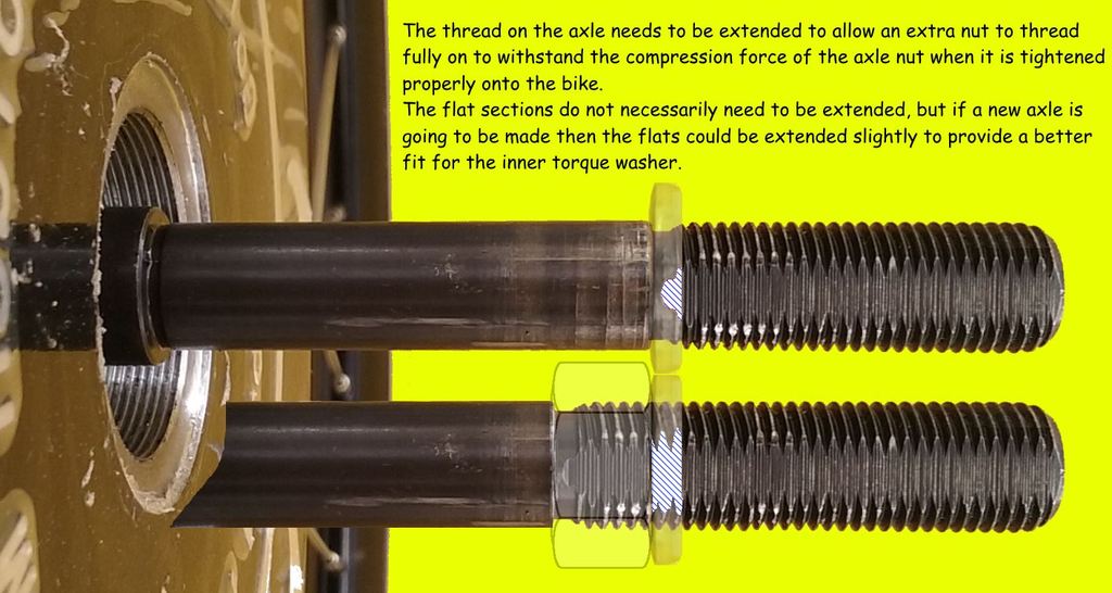

I therefore suggested that the axles could be modified to allow a nut to be threaded further onto the axle and further inside the freehub locking nut to maintain the correct axle width to suit the standard 135mm wide rear dropout:

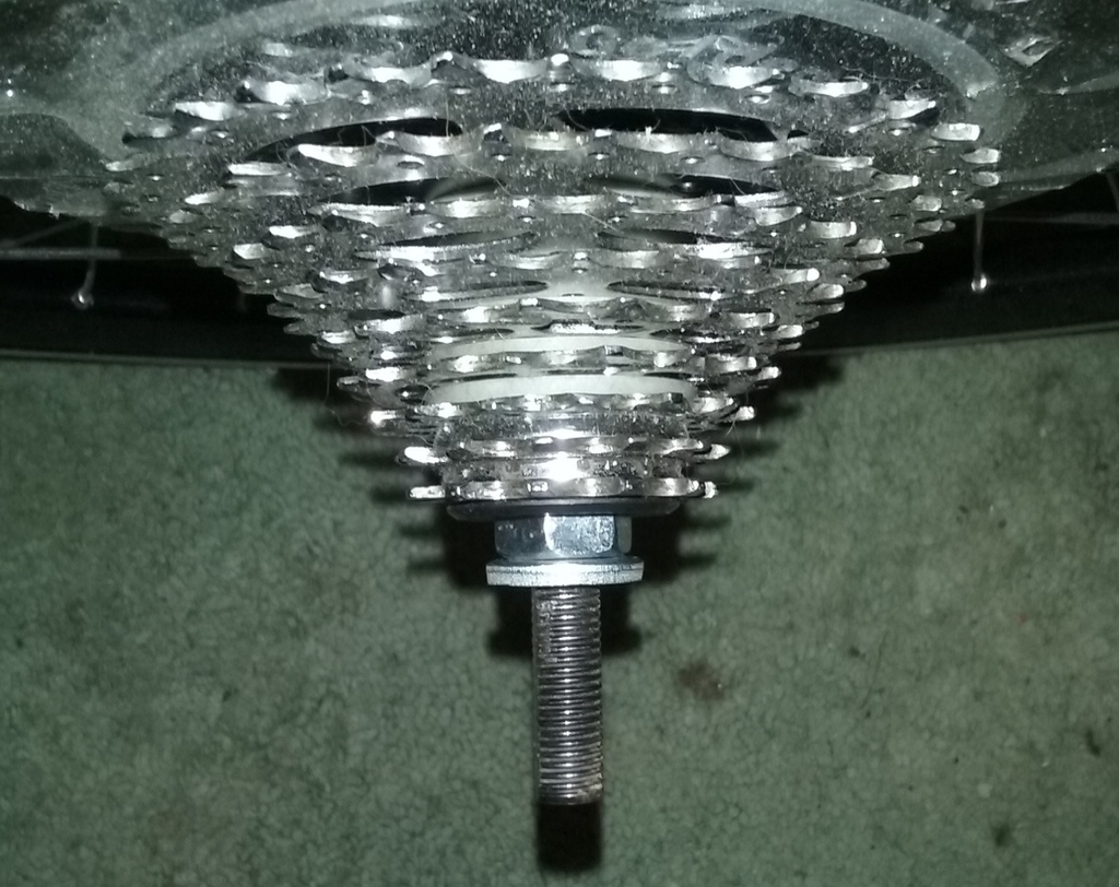

However, I believe that the axle was not actually modified, but an extra inner nut was simply added to the existing axle to withstand the compression force of the outer axle nut.
Unfortunately, the additional thickness of the nut increases the overall mounting width of the axle by ~7mm:

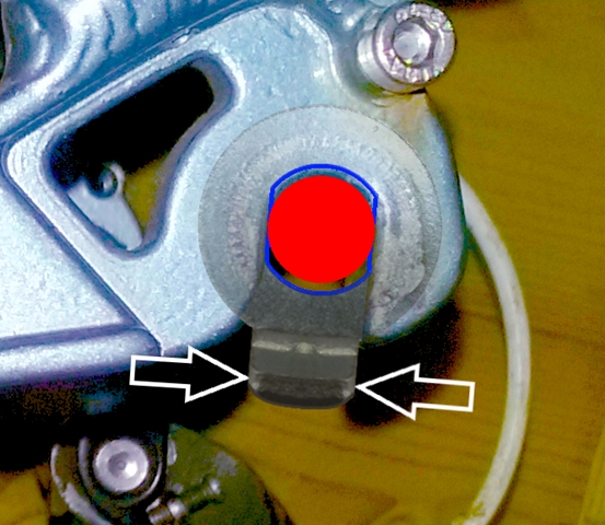

It is also worth noting that the dropouts on most modern bike frames are not actually deep enough to allow the tab of the torque washers to even locate within the dropout slot:
On my front mounted Smart Pie, I decided to bend the tabs back on themselves so that they would actually locate inside the dropout slot:

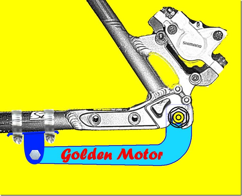

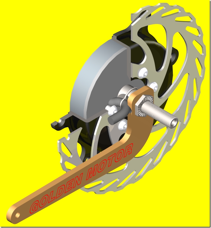

I suggested that it should be possible to modify the existing axles (or produce a new axle) along with a dedicated torque arm that would easily transmit all the motor torque under full load (and during regenerative braking) directly to the frame:
Unfortunately, GoldenMotor decided not to adopt my proposed torque arm system because they were concerned that it would not be compatible with all the different frame types.  :(
