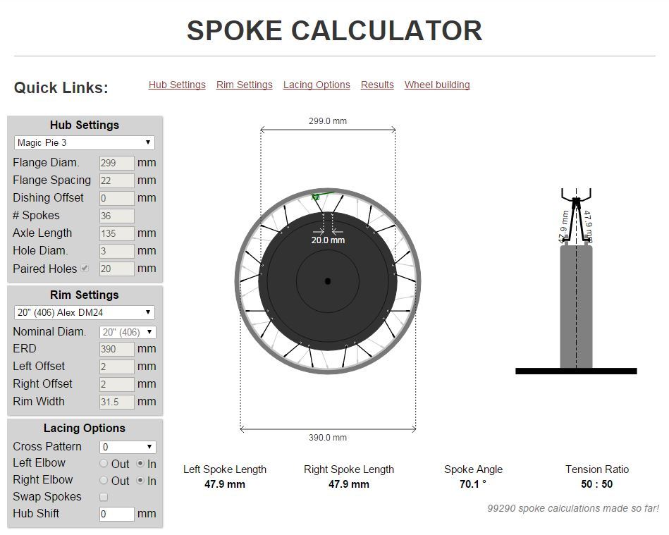

Alan, Thank you so much for the info! Looks like getting the right spoke angle is going to be the toughest part. Can you help me understand what's considered a "conservative spoke angle range," a "moderate spoke angle range," and an "extreme spoke angle range"?

The original 26" Magic Pie spokes had a very large angle of nearly 30 degrees, which I'd describe as both extreme and totally unacceptable as it results in badly deformed/stressed spokes instead of straight ones:
I would say a moderate spoke angle would be between 12~20 degrees maximum, but sometimes you simply have to make do with larger angles and distorted spokes in preference to radial spokes (0 degree spoke angle means the spokes are perpendicular to the rim and therefore not ideal for transmitting torque).

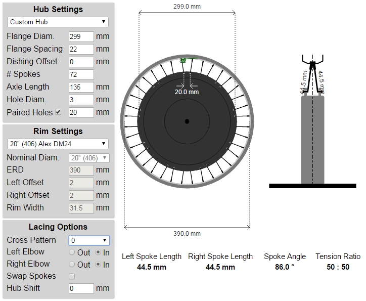

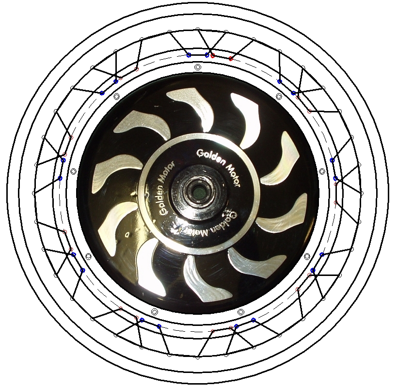

If you can find a suitable rim (and the correct length spokes) it should be possible to lace the rim as shown here:
I had to enter 72 spokes (instead of the Pie's 36) to enable the spoke calculator to produce the required spoke angles and length for this particular spoke pattern (and I then edited out the unused spokes to avoid any confusion).
The Pie's offset "paired" holes in the hub would produce a spoke angle of 4 degrees (90-86), which would be similar to a conventional bike wheel spoke angle and will resist a lot more torque than the sometimes used 0 degree radial lacing.
