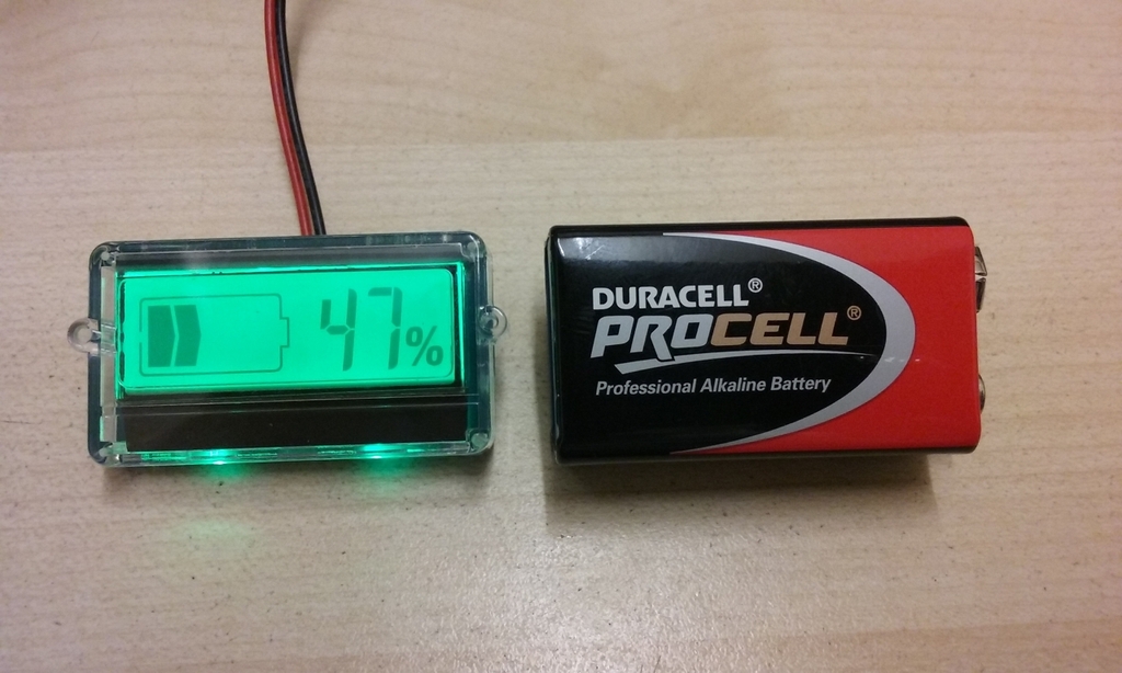

Here is a very neat little gauge that shows the approximate battery capacity based on the battery voltage, I have one of these waiting to be fitted into my 48V 10Ah GM Battery:
If fitted from inside of the end cap and suitably attached and sealed using silicon sealant and a hot melt glue gun, it should be well protected from the weather.

When you say the throttle mounted LEDs are inaccurate - do you mean they underestimate or overestimate the amount of battery remaining?
Where can I buy your shown battery gauge?

The gauge shown in the previous photo was purchased from here on eBay and can also be used with a wide variety of batteries.

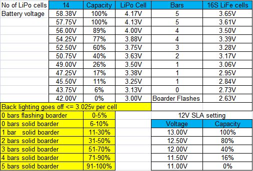

Here are the results of some test voltages applied to the gauge via a variable voltage power supply:
The 14S LiPo setting seems to work reasonably well for the 48V LiFePO4 battery.
