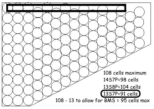

Even if it has the stated cells, it will not have the stated capacity, as there is physically not enough room within those dimensions to accomodate the required number of cells, even without the BMS unit!
I tried various layouts using my CAD package but could only manage to fit around 108 cells maximum in the same sized space, and ~13 of those would have to be left out to allow room the BMS to fit inside:
Unless the physical dimensions are larger than the ones quoted, I reckon they will have used 91 cells (13 series sets of 7 paralleled cells).
If the cells are the stated 2.2Ah cells, this would only produce a maximum capacity of 15.4Ah instead of the stated 20Ah.
You can't have a capacity of 20Ah using 2.2Ah cells, it would either be 19.8Ah for 13S9P or 22Ah for 13S10P, but there definitely isn't room for 117 or 130 cells in that size package. ???
If your charger's voltage is marked as 54.6V, it will definitely be a 13S pack, but if it is marked as 58.8V it will be a 14S pack.
If it's a 14S pack, it will probably only have 6 cells in parallel blocks and the total capacity would then be just 13.2Ah, unless they have somehow managed to squeeze 98 cells and the BMS unit inside the stated dimensions, but I don't think that is very likely.

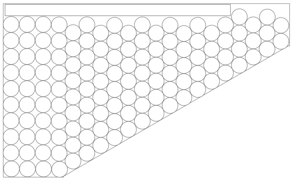

That's a big difference in the dimensions, and with a slightly smaller BMS it looks like there's enough room to squeeze in 130 cells:
So it could actually be 13S10P 20Ah.
