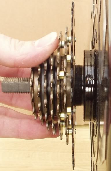

I think you must have been dreaming about the freewheel spacer:

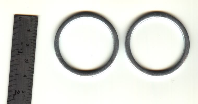

The Magic Pie is supplied with a couple of spacer shims (narrow washers) tie wrapped to the axle:
These should only be used if there is not enough clearance between the freewheel and the hub without them.
The freewheel should screw easily onto the threaded boss, and excessive force should be avoided. If it doesn't thread on easily first time, remove it and try again, taking great care to ensure it is aligned correctly so as to prevent any possibility of cross threading it.
If the freewheel binds against the hub, fitting a single shim will hopefully be enough to cure the problem.
The shim is easily fitted by simply placing it on the threaded boss on the hub before the freewheel is screwed on.
If one shim doesn't provide enough clearance, it might be wise to consider using a different freewheel instead of additional shims.
Fitting more shims will further reduce the amount of thread available for fixing the freewheel, making it more prone to stripping the soft aluminium threads on the hub under heavy pedal pressure.
The shim occupies a small portion of the threads visible in the picture on the right, which will prevent the freewheel from being threaded on too close to the hub.

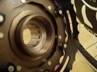

This photo was taken before the freewheel had been fully screwed on:
(With my freewheel, a shim was not required and is therefore not shown in these photos)

Please Note: the above freewheel spacer shims should not be used for spacing a brake disc which bolts directly to the hub on the Magic Pie.
The brake disc must have a suitable flat surface area where it contacts the hub to ensure it can be correctly tightened without causing any distortion of the disc.

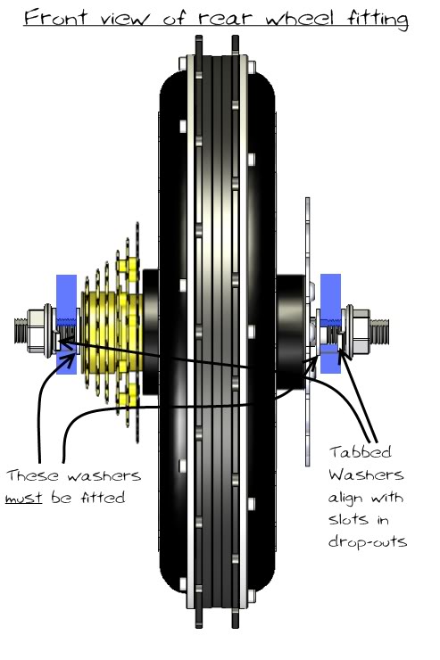

Ben, I have just been studying your photo and I cannot clearly see the washer on the axle which should clamp against the inside edge of the dropout.
Without this washer, it can seriously damage your frame when the axle nuts are tightened.
If it isn't fitted, it would also explain why you needed to shave away part of the caliper fixing bracket to prevent the caliper touching against the hub.
I would suggest spacing the disc until the caliper clears the disc mounting flange on the hub and then
space the axle from the dropout using the correct width washer (if it is not already fitted) or add an additional washer if necessary.

Oh Alan - Is it not clear from the picture that I am trialling GM's new transparent washers - It is quite hard to spot in that picture  ;).
Of all the times I've installed a pie (I've only owned 2 but they have been on and off more times than I can remember...) I'm pretty sure that's the first time I've left that washer off which makes it the perfect time for me to take a picture of it and post it on this forum lol  :-[
Ok - the washer is back in place and thanks very much for spotting that - I won't be doing that again  ::)
