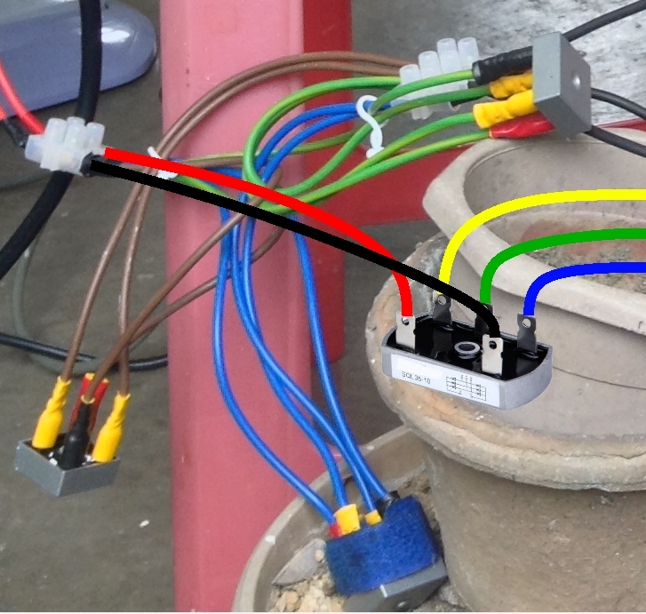

id already success test the conventional normal way to create generator using Magic Pie 5 hub... take out the controller & connect the 3 wires to Bridge Rectifier (35a 400v) then connect to inverter...
more power can get, I think with this method compare to connect inverter to Magic Pie internal controller..

Take out the controller & connect the 3 wires to Bridge Rectifier (35a 400v) then connect to inverter...
A single three phase regulator would have made the wiring a lot easier:
(Click on image for more information)
And you would only need 5 wires/connectors instead of twelve, and just one regulator instead of three.
Although, your way does have some benefits - it doubles the current capability of each rectifier to 70 Amps and almost trebles the heat dissipation!  ;)

hi Alan,
well.. I cant get yet that 3 phase bridge rectifier in 1 piece as you show there locally.. will update when I can get it..
id manage to cycle to support 170watts of power, a combination of empty blender & two desk fan.. in 24v its harder to maintain cycle 20kmh with the heavy resistant! haha
by the way.. great photo editing there Alan! :)
