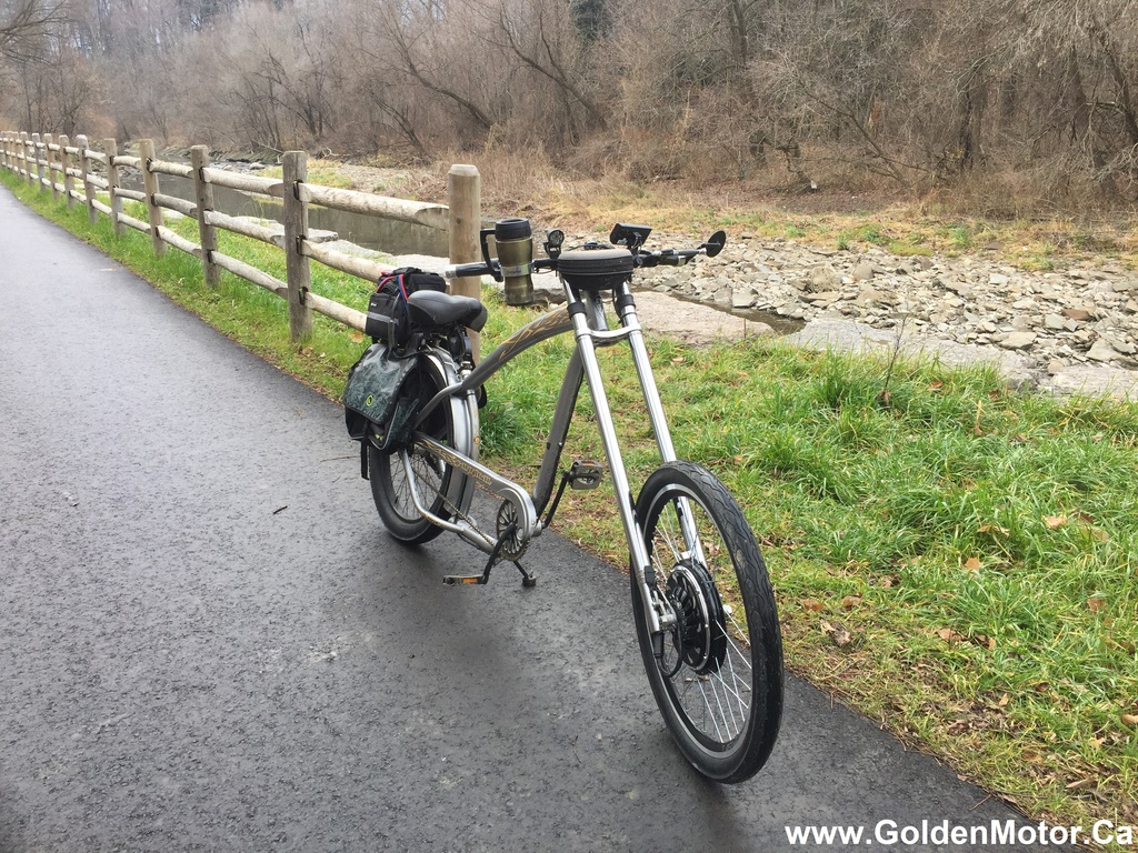

For those of us with a 500 watt restriction I have been asking Golden Motor for a 500 watt rated motor for a long time and here it finally is. New for 2016 is "The Magic Pie Edge". The motor is rated at 500 watts and It has the same internal Sinewave Controller (v5.3.1 w Bluetooth) and is compatible with the same wire harness and controls of the v5 pies. Really it's like the Magic Pies Little Brother.

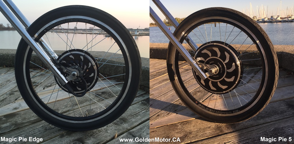

I have been road testing two Edge kits since mid-October and I really have to say they are awesome! It feels very similar to riding around with a Magic Pie but less power of course. On the first ride after switching my Cannibal from a Magic Pie 5 to a Magic Pie Edge I rode off on my first test ride. I was quite impressed by the power. Logically because it is smaller it has less power than the 1000 watt Magic Pie, but because of the shape of the motor it has quite a bit more torque then the 400 watt Smart Pie. The Edge is thin with a large Diameter like the Magic Pie. This means the magnets are further out on the wheel then they are on the Smart Pie and gives it more bottom end pulling power.
For more information of the new Magic Pie Edge, follow the links…
Video https://www.youtube.com/watch?v=72Nz-EbNTvM
Blog http://www.goldenmotor.ca/news/187/MAGIC-PIE-EDGE-Released.html
Newsletter http://us4.campaign-archive2.com/?u=7551f46cb9e3794e811a370cc&id=1d239ea572

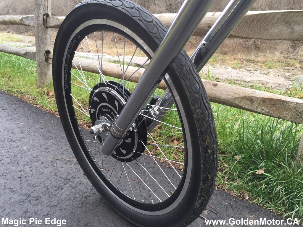

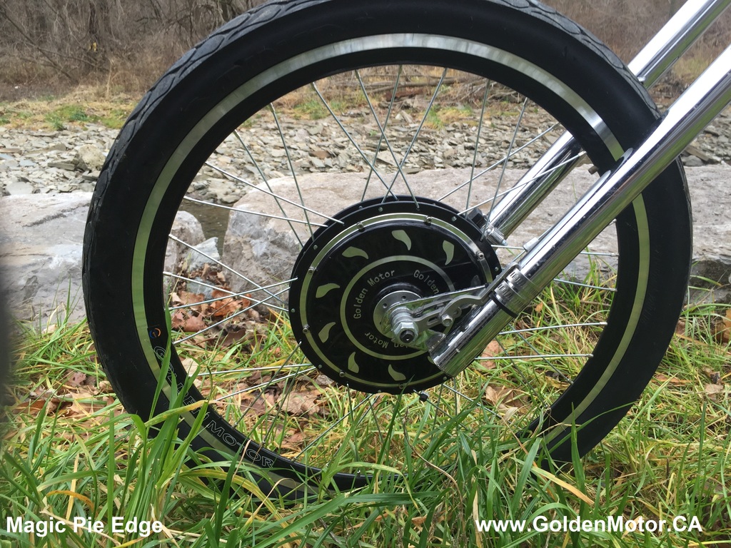

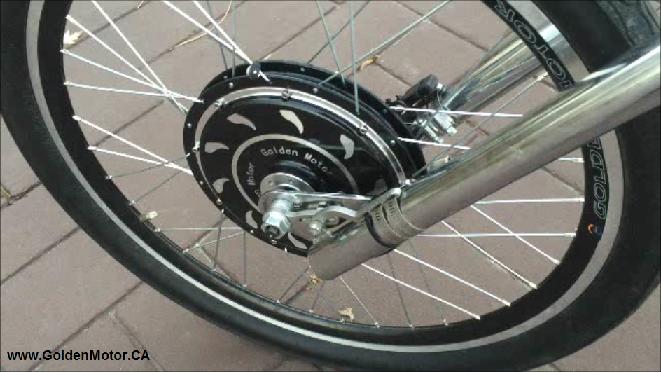

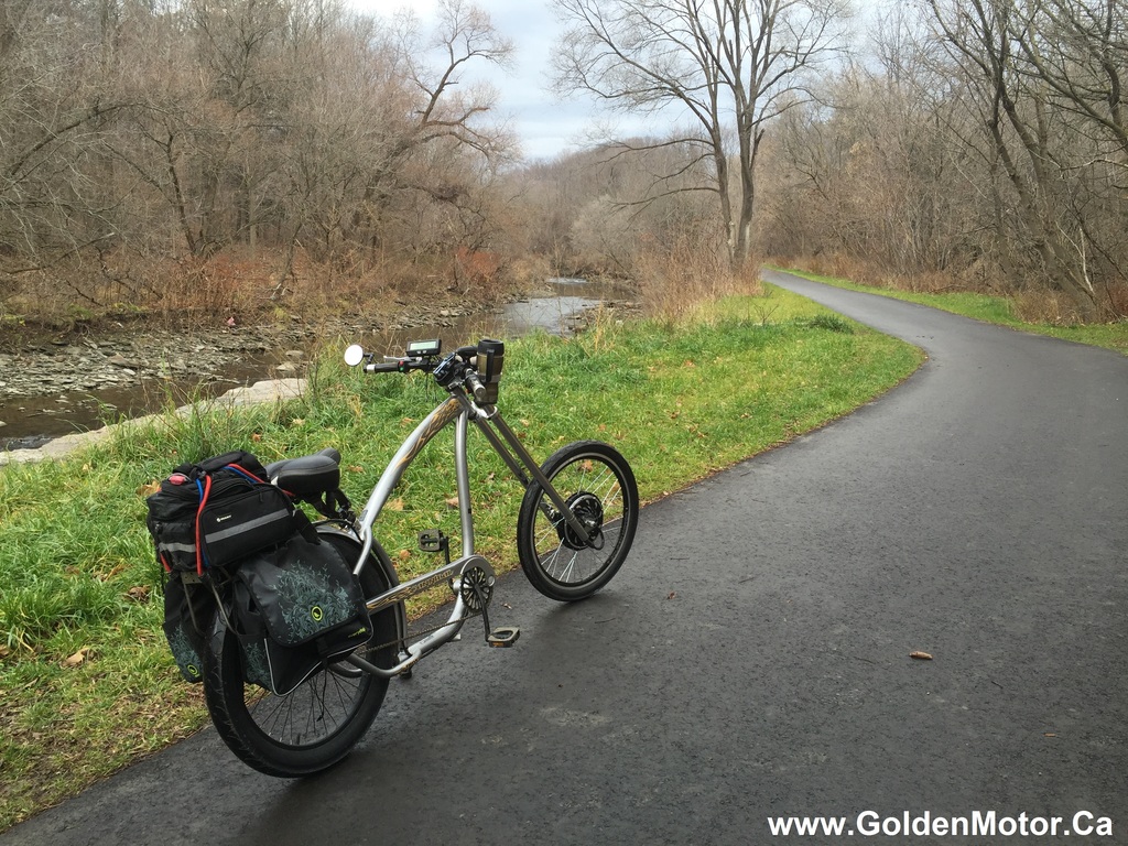

This is a good size comparison with the Magic Pie Edge and Magic Pie 5. Plus a few pictures of a ride though part of Etobicoke Creek Trail. Definitely one of my favorite trails.
What an Awesome place for an Ebike ride!

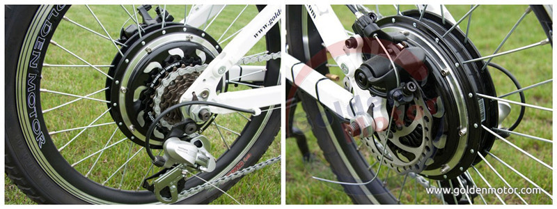

So the edge looks a bit smaller than the regular MP5, how would it fit in a 20" rim?  Does it still come in a cast rim at that size, or could I fit that into a regular rim with some suitably stubby spokes?
Re: Magic Pie Edge - The Perfect 500 Watt Solution!
« Reply #3 on: July 04, 2016, 12:12:39 PM »
The 20 inch Edge is spoked. AT least for now. I have some arriving this week. I should be able to upload a picture then.
« Reply #4 on: July 04, 2016, 01:25:14 PM »
Hi Gary,
Do you know if they are radially laced, or laced with leading spokes on one side and trailing spokes on the other like the 20" Smart Pies:
« Last Edit: July 02, 2017, 04:29:17 PM by Bikemad »

Hi Gary,
Sorry Alan, quite a delay on responding here. The 20 inch edge is with leading spokes on one side and trailing on the other.
There is also a 16 inch cast version of the edge now and I really should update the site with a new picture of it :)
