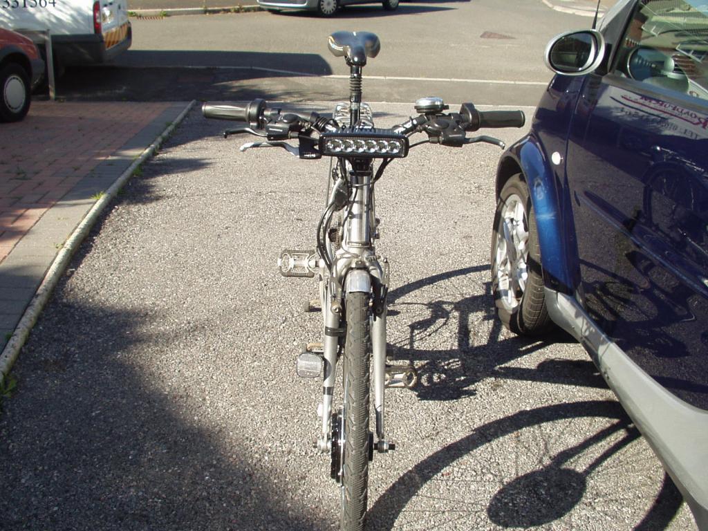

Please Note: If you have 24V or 36V LED lights powered from a 24V or 36V battery they might not appreciate being fed with 48V:
The 10-30V 18W LED Light shown above died instantly when I accidentally knocked the light switch by mistake while testing the Smart Pie with a 48V battery. ::)
