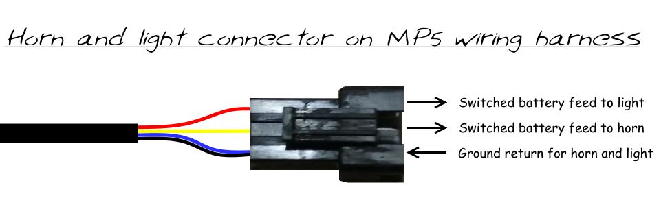

Here are the details of the light/horn connector that was factory fitted on my most recent Magic Pie wiring harness:
I would expect your three pin connector to connect the red to red, yellow to yellow and green to the combined black/blue ground return.
Please confirm whether (or not) this actually matches the connector on the cable fitted to your GM LED light/horn unit.

Chris, that is actually the correct mating connector and would plug perfectly into my harness connector as it's the same style JST SM connector that the early Magic Pies used:
If you look on the opposite side of your connector you should see a small ramp in the centre where the clip on my connector would hook over to prevent the connector from coming apart on its own:
