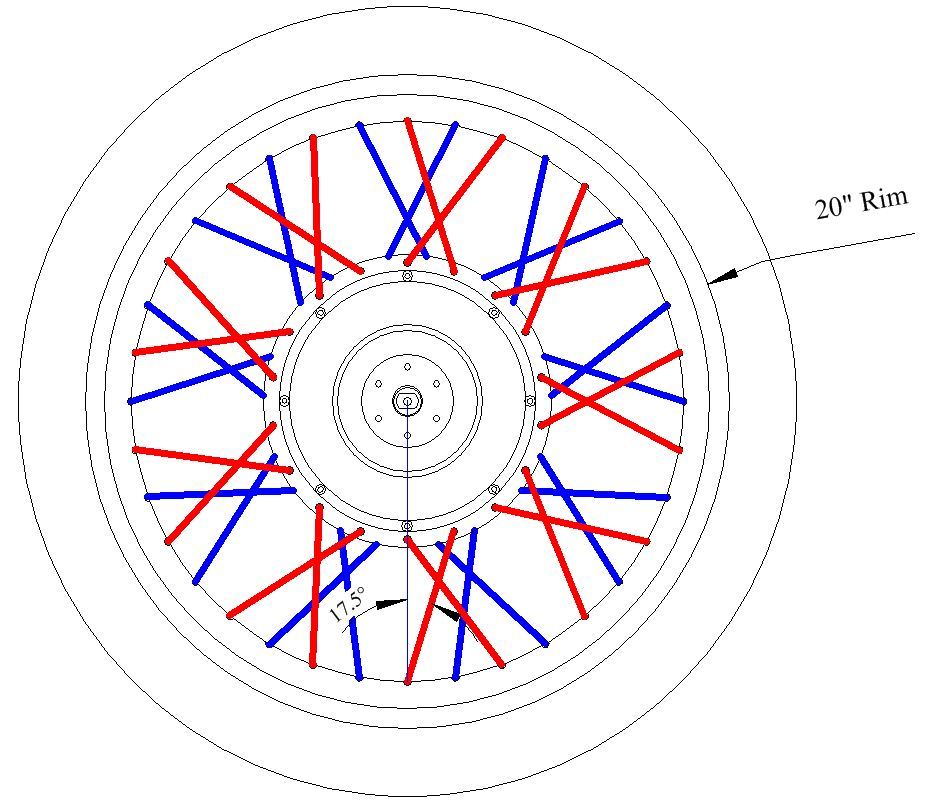

It should be possible to build the Smart Pie into 36 hole 20" rims, but the conventional crossed spoke pattern would result in excessive angles between the spokes and the rim:
To avoid excessive spoke angles at the rim, GM assemble their 20" wheels with all the leading spokes on one side and all the trailing spokes on the other:

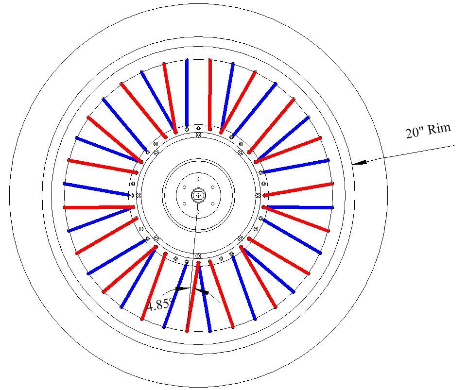

A much better method of installing the Smart Pie into a 20" rim (or smaller) could be achieved by drilling another 36 holes in the hub flanges as shown here:
This would allow a more conventional spoke angle with trailing and leading spokes distributed evenly on both sides of the wheel:
With a 72 hole hub, it would even be possible to fit the Smart Pie into a 16" rim if required:
