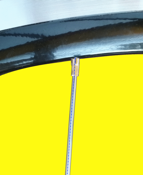

Why not mark the direction of the spokes on the assembled wheel, disassemble it, then angle drill the spoke holes to reduce the bend angle of the spoke where it meets the nipple.
Unfortunately, it's not quite that simple. If you had a drill shaped the same as the nipple outline it might work, but I suspect you would drill right through the rim on one side of the hole making it very weak and likely to allow the nipple to pull through.
When the spoke is loose it will often allow the nipple to align correctly, but as it is tensioned, the nipple is pulled towards a natural seated position inside the rim, which causes the spoke to become badly bent and strained at the nipple end.
I have already tried to explain why this happens using a simple diagram:
But now I can clearly demonstrate what actually happens in real life.
The hole in the rim is already large enough to allow the spoke nipple to exit at the required angle (albeit excessive), but just look how much its angle changes as the spoke is subjected to tension:
The only reason for the excessive spoke/rim angle is to accommodate the larger hub, but this causes the spoke to exceed its working angle:
The problem can simply be alleviated by mounting the spokes at a more acceptable (more conventional) angle by offsetting the holes in the flanges as implemented on the revised Magic Pies:
As the resultant 9° spoke angle is far greater than a conventionally spoked wheel, it will place less load on the rim when the wheel is under torsional load and will have no problem whatsoever in transmitting the maximum torque from the hub to the rim (unlike radially spoked wheels which typically place tremendous loads on the rim).
In my opinion, the excessive angle caused by the crossed spokes on the above Magic Pie is simply unacceptable, It would not be a problem if you were lacing the hub into a motorcycle type rim that was specifically designed to allow the spokes to exit at a large angle:
Many people are under the false impression that the increased angle is required to cope with the huge torque of the hubmotor.
But let's consider the front wheel shown in the above picture which, as you can clearly see, does not have excessively angled heavy duty spokes, yet under heavy braking on a conventional eBike, it will have to withstand a lot more torque being transmitted through the relatively tiny flanges on the standard disc brake hub than the Magic Pie is even capable of producing!
Check out this post for more information regarding preventing broken spokes.
