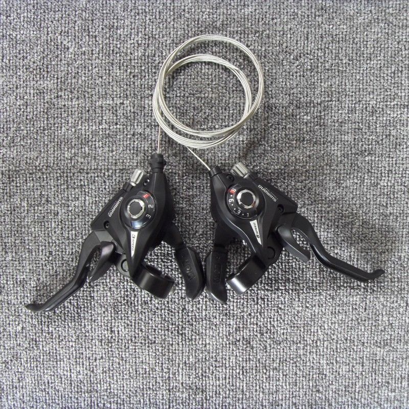

If you buy one with the gear changers combined with the brake levers, you will need to use different gear changers when you install the GM brake levers.
Don't think ive ever seen a gear changer combined with a brake lever (so maybe im misunderstanding you?). Right now im thinking of using my own bike, or something like this:

Don't think I've ever seen a gear changer combined with a brake lever (so maybe im misunderstanding you?).
Unfortunately, I have this trigger action style of changer fitted to one of my bikes and it is a real pain to use:
I have had to fit a separate brake lever to operate the regen and because the gear change is sequential I can't change through the gears fast enough to keep up with the acceleration of the motor on the level. ::)
