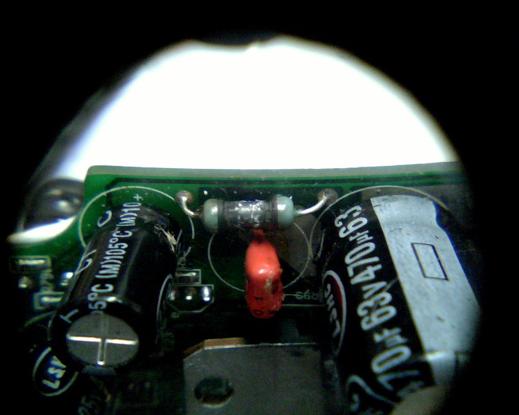

So I finally got around to popping the side cover off of my Magic Pie to inspect the hall sensors...
http://i.imgur.com/I6dXKYk.jpg
I applied power to the positive and negative directly on the board and then noticed a flame that came from this resistor on the controller! :'( (I cut the power and unplugged right away):
http://i.imgur.com/ovKR0vf.jpg
Did I do something wrong? Is this controller definitely fried now? Any advice appreciated :D

How many volts did you apply where?  Smoke from components is a sure sign of damage.

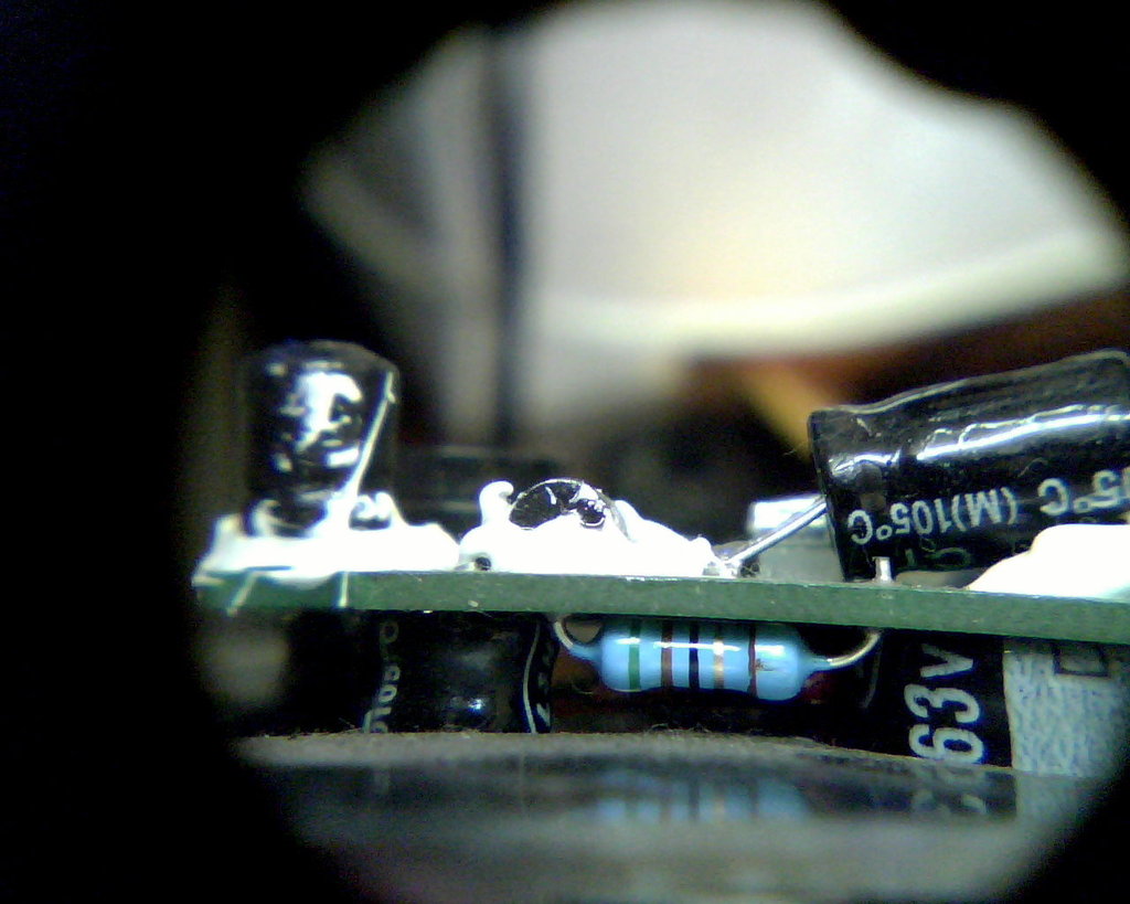

I have just been studying a couple of controllers to try and determine what the resistor is for, but it's impossible for me to trace the circuitry.
This it what it should look like:
If I've interpreted the colour code corrrectly, the resistor seems to be a 51 Ohm resistor with a 5% tolerance.
One of the controllers I was looking at was the one I blew up when I tried a dual controller modification, and I discovered that the resistor had been nicely cooked on that one as well:
I would say that something on the controller has short circuited and caused the resistor to blow, and when my controller blew it managed to kill all three hall sensors at the same time!
I think you will have to replace the controller with another internal one, if you can still get them, or you may need to convert the motor to allow the use of an external controller if you can't find a replacement internal one.

I applied 54V to the large red and black (battery wires) wires where they are soldered onto the board. That is the connections on the board to the left in the first picture. That was just to give power to the controller. My thought was that once the controller had power, it would be supplying +5V to the hall sensors and I could proceed with testing them. It was a terrible smell, with a bit of flame too :-[
This controller was already replaced last year and GM Canada doesn't seem to stock the MP2 internal controller any more. So if I can't repair this one, I may be looking at a new setup for my front wheel.

 My guess (based on 40? 50? years of electronic troubleshooting) is that the resistor is for dropping voltage to the 5vdc? analog voltage regulator.  Here is my thought train…..  Your photo shows a 470 MFD 63 Volt rated electrolytic capacitor in physical proximity to a high wattage resistor.    It is a fairly common design to have a filter cap with the voltage dropping resistor in an analog regulator circuit.  Electrolytic caps are notorius for failing under voltage stress near their rating.  By near their rating, I  mean avoid stressing them over 75% of their rating.  i.e., nothing over 45VDC for a 63V rated cap.  54 VDC is way to high a voltage to put across a 63 V cap, in my opinion.
So, if you want to try replacing the resistor, by all means you should try it. I would suggest taking the cap out of circuit, and testing it for failure as well.

So I just ordered some resistors FYI I think its a 51ohm resistor (they only had 2%). Same physical size as some 1/2W resistors I had lying around. I have my older internal controller still and had a look at it.... I'm hoping thats all that is blown. Here is a better shot:

Just an update... I received the resistors and replaced the one on the board but the new resistor suffered the same fate. It too has burnt out once I applied battery power to the controller. I think the time has come to retire this MP2.
